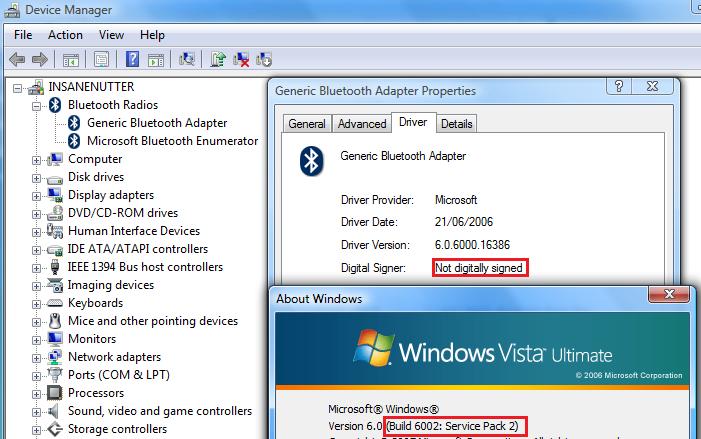

    Press the windows key and r to open the run box, type in services.msc.
    Find Bluetooth Support Service.
    Right click on it and go to properties
    Change start-up type to automatic, then if the service is not started click the start button below.
    Also be sure to have a look at my guide on how to disable driver signing here: http://digiex.net/guides-tutorials/1...4-bit-x64.html Do so then install the drivers.
    You shouldn’t need to modify / sign the drivers in any way if you do the above.
    Good luck.
    Attached Thumbnails Attached Thumbnails Driver for ISSCEDRBTA Bluetooth Dongle in Vista 32-bit (x86) and 64-bit (x64)-bluetooth.jpg
