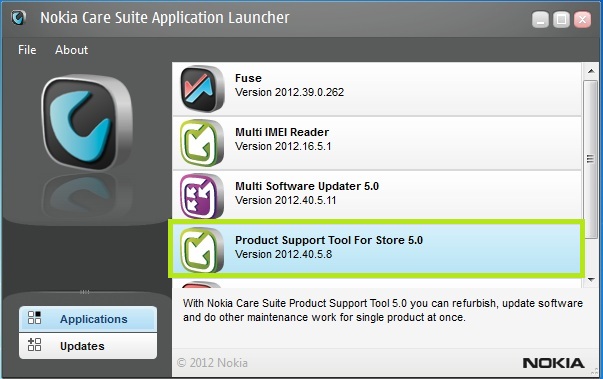

Now connect the Nokia Lumia 710 to the PC with the USB cable, load up Nokia Care Suite, then choose and open “Product Support Tool for Store 5.0”
Attachment 12518
Write down the type designator and product code for your Lumia 710, you will need this later:

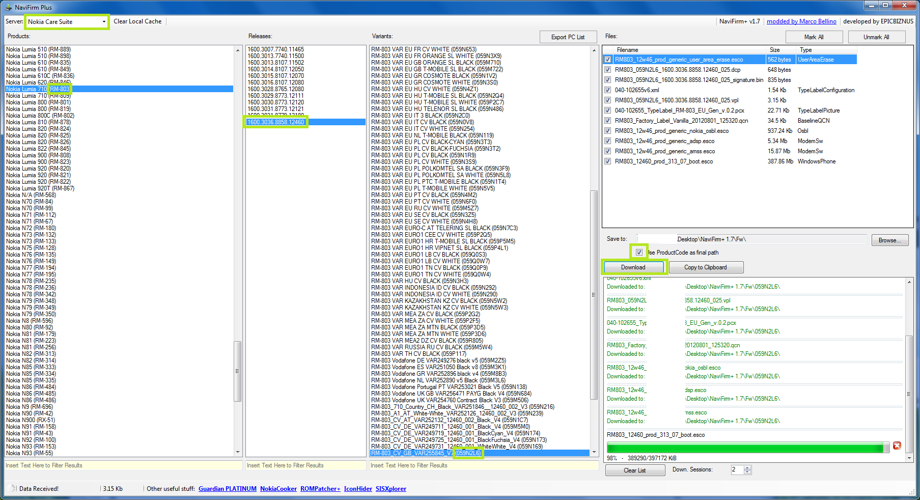

Load up NaviFirm, on the top left of the app you will see a dropdown, ensure “Nokia Care Suite” is selected.
You will then see a list of devices, select "Nokia Lumia 710 RM-803" or "Nokia Lumia 710 RM-809" depending which version of the phone you have.
The newest firmware will be at the bottom of the releases box, at the time this is 1600.3036.8858.12460 - this is Windows Phone 7.8
For the varient look for your product code (you obtained this earlier), then select the varient with your product code.
Finally press the download button, the above steps are shown in the screenshot below:
Attachment 12527

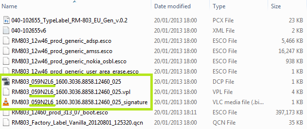

Now ensure the three files you have download have your product code in the file name, as highlighted in the screenshot below. Remember your product code could be different to mine. If the product code has not been auto inserted for you rename the three files manually:
Attachment 12521
Move the data you downloaded to C:\ProgramData\Nokia\Packages\Products\rm-803, if your device is an rm-809 then the folder will be C:\ProgramData\Nokia\Packages\Products\rm-809

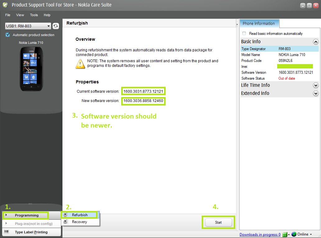

- Now load the Product Support Tool for Store 5.0 up again
- In the bottom left Select Programming, Refurbish.
- The tool should have picked up you will be re-flashing a newer software version, aka Windows Phone 7.8
- Click the start button.
Attachment 12522

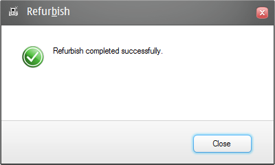

The update will re flash, and the phone will re start.
Attachment 12523

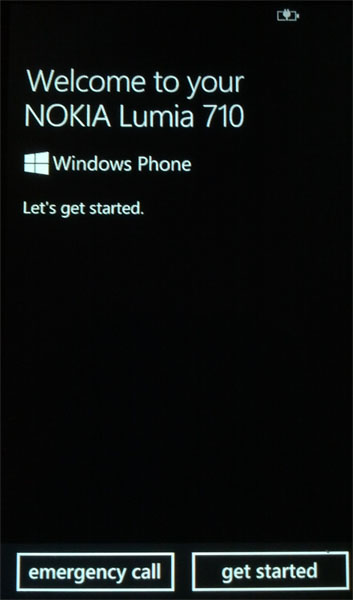

All been well you will be prompted to set the up phone again, you should be able to tell that you are on WP 7.8 as you will see the new Microsoft Logo.
Attachment 12525

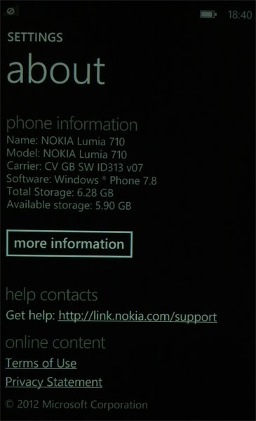

This can be confirmed in Settings > About
Attachment 12526
