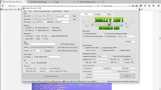

    Build the nand again exactly as you did before, however tick the "Disable FCRT.bin check" option. Flash that to your console and hopefully your DVD drive should work as it did before:

    Thank you so much for the help! it's working perfectly now :D
