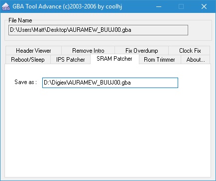

    So I recently finally ordered an Everdrive GBA, and after using the SRAM patch on this rom, I noticed the distribution counter always stayed at "0" no matter how many distributions I made. I then realized that when you select the rom on the Everdrive, go down to "ROM Settings" and set "Save Type" to SRAM, then select "Apply". After this the distribution counter worked as intended.

    I'm glad you managed to get that working perfectly on real hardware too, I did wonder if it was detecting the same type incorrectly. I'll add a note about the Everdrive to the original post as i suspect that is going to be one of the most popular flashcards going forward.

    Why would you sram patch roms on everdrive?

    The distribution counter displays "Backup Error" otherwise. But you just gave me an idea to try setting SRAM with an unpatched rom. That should work now that I think about it, I just know it's at least manditory with an old flashcart like InsaneNutter's.

    Does ED detect save type as Flash 128k by default for the distro rom though? Might need to be set manually
    https://krikzz.com/forum/index.php?topic=5488.msg42754#msg42754
    Could be worth a try. Disregard if you've already tried that.
    Otherwise I guess it's possible that there is an incompatibility between ED and this particular rom. :P

    Okay, so the default save type for this rom is "None". Setting it to SRAM still displays the Backup Error with an unpatched rom.
    Edit: I missed what you said about manually setting Flash128k, so I tried that and it indeed worked for the unpatched rom. That's good news.
    It's probably just because this is a weird rom. All the retail games are auto detected and save without any configuration, at least from my experience so far.

    It's not really a weird rom. ED simply uses gba release list database for save types, a database that the distro roms wouldn't be a part of (at least not yet.)
