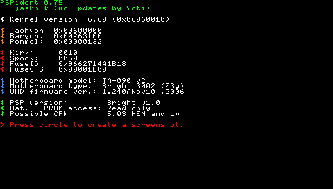

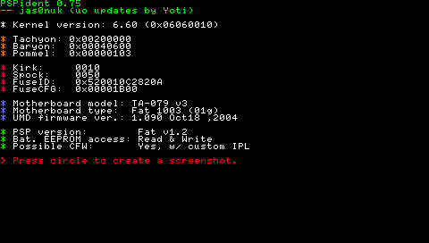

    Download PSP Ident
    Unzip and copy the program to your PSP > Game folder like you did with the custom firmware installer, then load PSP Ident up on your PSP:
    You will be presented with lots of information about your PSP, the screenshot below is from my PSP 1000:
    We can see that my PSP is a 1.2 the 1 been a PSP 1000 and it has a 79 V3 motherboard, which is capable of having custom firmware permanently flashed to it.
    Remember you can only permanently install this firmware on a PSP 1000 or a PSP 2000 that is not an 88 v3 version.

    So, uhh... not sure if mine is able to have permanent CFW...
  6. InsaneNutter
    12,548
    3,868
    Nope you cant unfortunately, you have a PSP 3000. However you can still use all the homebrew apps, load ISO's, modify games and so on. You simply need to launch the Fast Recovery app if you ever power the PSP off fully. By default the PSP doesn't do this anyway, so I can't see it been too much of an inconvenience.
