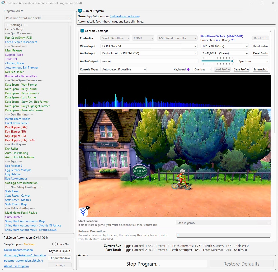

That's when i came across Pokemon Automation, essentially you can automate repetitive tasks on the Switch Pokemon games, such as hatching eggs to shiny hunt Pokemon.
The automation done by using a HDMI capture card, so your PC can "see" what the Nintendo Switch is doing. The PC can then react by controlling the Switch over USB with an ESP32-S3, this is essentially a micro computer that is emulating a Switch Pro controller. The ESP32-S3 is connected to both the PC and Switch via USB, so the Switch doesn't need to be hacked at all. (With that in mind this also works on the Switch 2.)
As you can see from the screenshot below the list of automations possible for each Pokemon game are quite extensive:

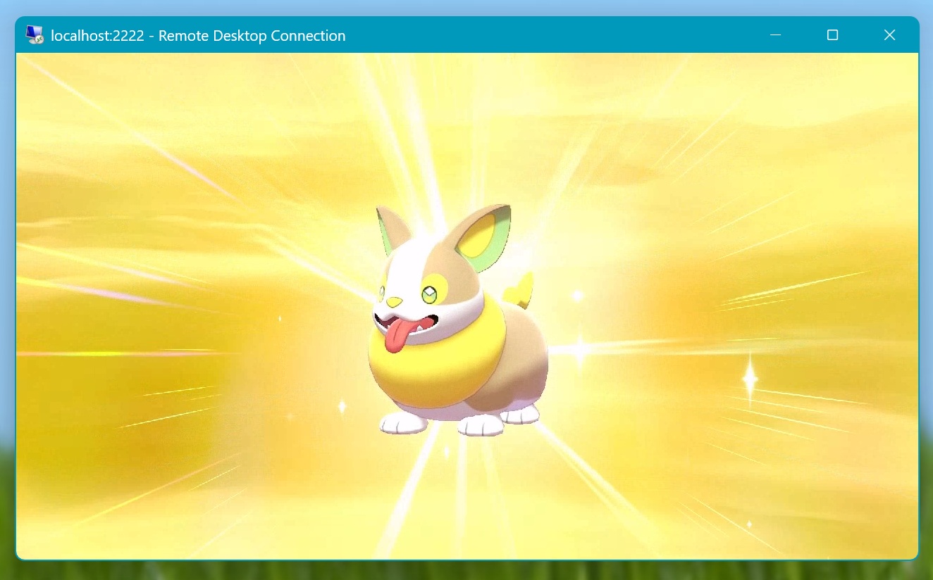

It's also possible to make the video output full screen and Remote Desktop (RDP) in to the PC controlling the Switch, so you can manually control the Switch yourself over the internet.
Obviously, you have the latency from the Switch to the capture card, then the latency of using RDP over the internet to view and control this. So you are never going to be playing competitive Mario Kart for example.
However, its certainly responsive enough for me to check on the Switch during lunch break at work and swap the Pokemon in daycare to next Pokemon I wish to shiny hunt if I’ve managed to hatch a shiny.
In addition RDP is allowed at work, installing a capture card and docking an Nintendo Switch to my work PC would probably not go down too well!
(For security I’m using RDP via an SSH tunnel, hence the localhost:2222 in the screenshot.)
