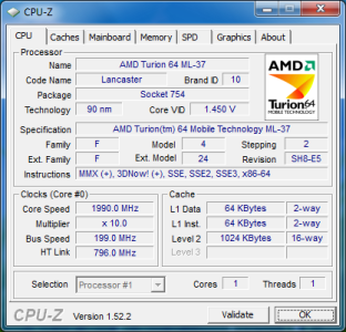

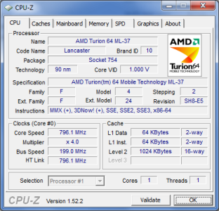

    When your laptop is not under load the processor should be under clocked, this helps keep the laptop cool and uses less battery power.
    Mine under clocks to 795Mhz when it's idle, then when I started playing a game it would clock its self back up to full speed, an extra 11mhz is not going to make much difference at all.
    Mine also only clocks to 1990mhz, I believe this has always been the case though.
    CPUZ screenshots attached.

    My laptop never goes down or up the 1989.8 MHz! The thing is, if i overclock the RAM to DDR 400 without the little overclock on the CPU, the RAM is assumed at DDR 398 instead of DDR 400, then something is wrong about the CPU difference. And even without any type of overclock, the Ram clock is wrong, (165.8 MHz instead of 166 MHz). I attached some images that show the problem. I can't understand why Acer never do an update for the Bios that gaves support for DDR400, because i use software overclock for this and it never had overheating. I have a Desktop, with a Asus K8v-SE Deluxe Motherboard and a Athlon 64 3000+ Processor, and it has Bios support for DDR 400, and it´s the same platform that the Ferrari 4000.

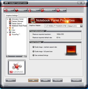

    With Windows 7 you'll notice that games and programs will run faster than in other OS, but i found a little problem with games (with modded 9.11 mobility catalyst drivers), when you run a game with a lower resolution than 1680x1050 or change the resolution in Windows, the display will not fit the screen. To correct this, you need to go to Catalyst Control Center and change the Panel Settings to "Scale image - full panel size" in Notebook Panel Properties. Unfortunately you'll need to do this whenever you restart the laptop (every time you want to run a game, of course).
