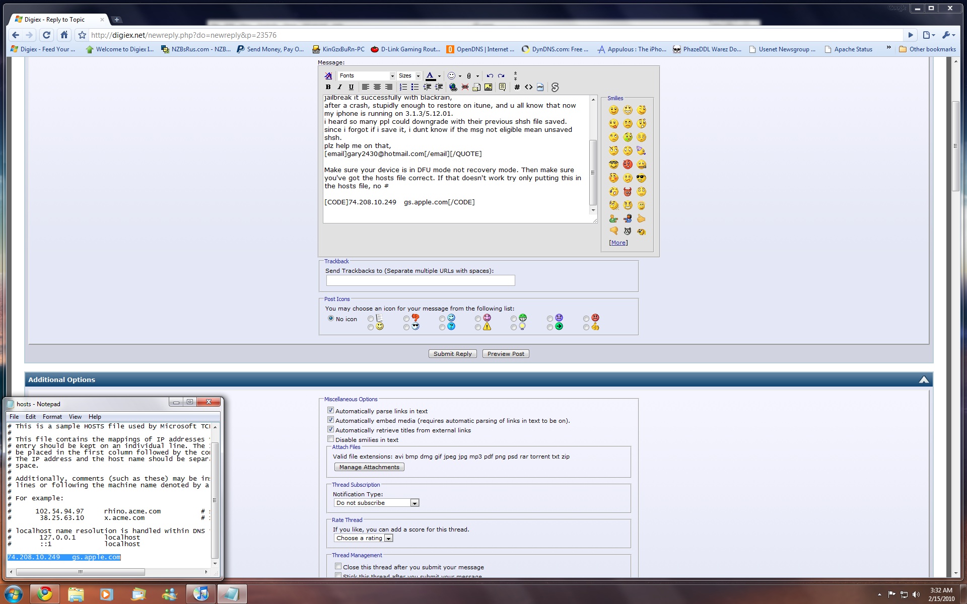

Make sure your device is in DFU mode not recovery mode. Then make sure you've got the hosts file correct. If that doesn't work try only putting this in the hosts file, no #
Code:
74.208.10.249   gs.apple.com
and of course make sure you have a shsh on file on cydia, that required you to hit the make my life easier while you was on 3.1.2 with cydia open.
if you had iTunes open while editing the hosts file, perhaps reopening it or even a restarting your pc. I just tested it though and it does work...your messing up somewheres.
