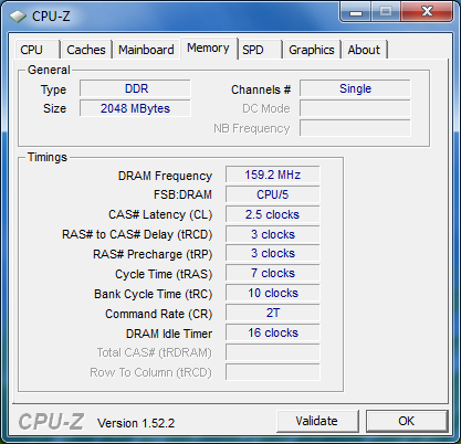

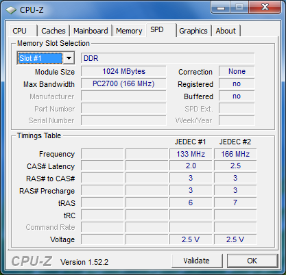

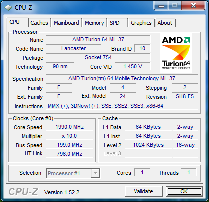

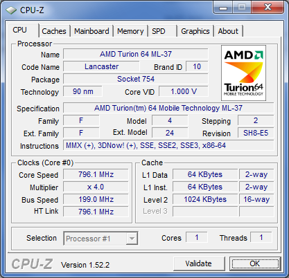

Default
When your laptop is not under load the processor should be under clocked, this helps keep the laptop cool and uses less battery power.
Mine under clocks to 795Mhz when it's idle, then when I started playing a game it would clock its self back up to full speed, an extra 11mhz is not going to make much difference at all.
Mine also only clocks to 1990mhz, I believe this has always been the case though.
CPUZ screenshots attached.
