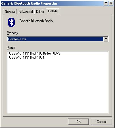

What I have done is modified the Bluetooth driver file that comes with XP SP2, to include this dongle by adding its hardware ID to the supported devices list.
Before you can install this, you must make sure you have updated your XP to at least Service Pack 2, as this included the Bluetooth Support Addon.
To install, download and extract all the files somewhere, like for example on your desktop in a folder called Bluetooth drivers. Then plug the stick in, Windows will fail to find the drivers and ask you to either provide a location for them, or provide a CD. Provide the location and give Windows the folder location of the extracted drivers. Windows will now install the drivers and your Dongle will be ready for use.

Installation of driver from cd went ok but the program doesnt detect the dongle, so i uninstalled it and downloaded this one, did everything as written in 1st post but as i already said, when i point the wizard to folder it just skips like nothing is there. I think i have this device cause in device manager its described as ISSCEDRBTA and its identical as one in pic.
Then either its not the same for some reason (perhaps they changed their hardware?) or Windows is refusing the drivers because it thinks it has good enough ones. Go onto the Device in Device Manager and delete its current drivers then try to replace with these.
Tried it and it doesnt work, then during wizard i chose option not to install, will choose drivers and then tried bluetooth device and bluetooth radio and then pointed installation to bth.inf only to get message "the location does not contain information about your hardware". Im starting to think the dongle is malfunctioned from the start, i'll just go and buy myself a decent one this time.
So i gave it one last shot, i found in IVT Readme some commands to add in .inf files in BlueSoleil folder and sys32 if device doesnt work properly, tried that and it didnt worked so i changed VID and PID number in commands to ones from device manager dongle properties page, that didnt work either. Im off to buy another dongle, any http://www.google.com/search?hl=en&...um=0&ct=result&cd=1&q=recommendations&spell=1recommendations ?
