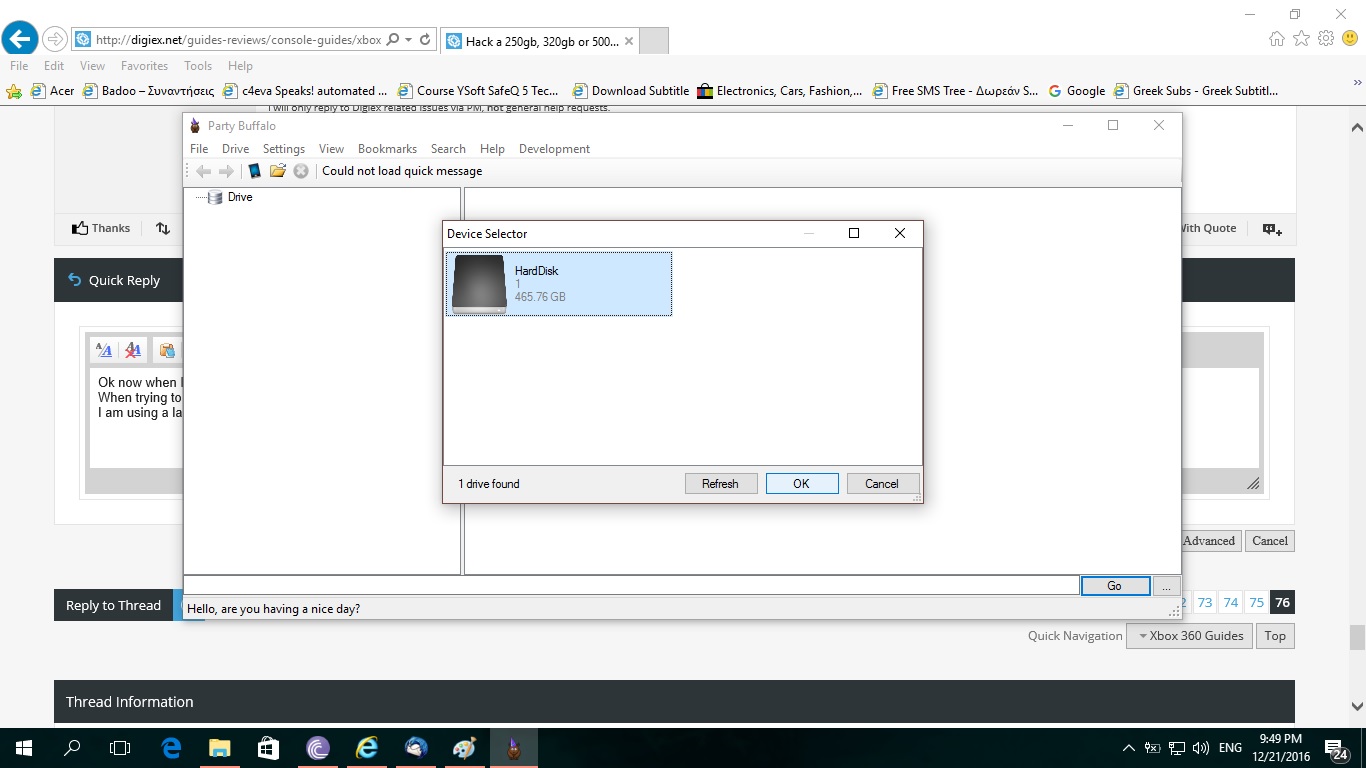

    Ok now when I do File-Open Device Selector I can see the hard drive but as soon I select "Open Drive" the program loads "forever" and does not display any visible indication.
    When trying to use the program "Party Buffalo Xbox 360 Drive Explorer 2.0.1.0" and as soon as I select File-Open Device Selector and then choose the hdd I get the error "unhandled exception has occurred in your application".
    I am using a laptop Aspire 5740G with windows 10 Professional 64bit.
    I have captured print screens of the steps that I have done as well as the errors that I meet, I just don't know how to send them to you here.
    If it is possible and if it is allowed if you provide me with an email address I will sent the to you.
    One more thing I am running both applications with administrative rights and I also try to run them with various compatibility settings for Windows Vista & Windows 7 but still nothing works for me :-(

    If your using a laptop the only thing i can think is the Xbox 360 hard drive must be in a caddy, which for some reason it might not like. For example it might not be giving the hard drive enough power or doing something that is conflicting.
    If you have any antivirus software try disabling that too, as it's not exactly a normal activity trying to read / write to a FATX formatted hard drive, so they could also be interfering / blocking something.
    Also ensure you have the .NET Framework 2.0 and 3.0 Installed, follow the screenshots below on how to do this:
    As you can see Party Buffalo does work on the latest version of Windows 10 x64 1607 at the time of writing, so hopefully trying the above might get it working:
    I hope that's some help anyway, if not you could try buying the Official Xbox 360 Hard Drive Data Migration Transfer Cable - the official one works on the 360 so you can connect your old hard drive via a USB port and transfer data to the new hard drive in the 360.
    For that to work the hard drive you are connecting via USB needs to be from the original Phat 360 as it's in the shell capable of been connected to the Data Migration Cable:

    First of all let me say that you have my respect and my gratitude for persistently trying to help me solve this annoying issue.
    So I want to confirm the following :
    1) I have disabled the Nod32 Antivirus for the following hour so I could conduct my tests without any issues.
    2) I have net Framework 2 & 3 Installed
    3) I have connected the hard drive to my laptop through a usb hdd case ( to this case all other hdd's are recognized by windows).
    4) As soon as I connect the hdd to the laptop and open the power button windows makes that distinct sound "like it recognizes a new device" Although it can not be seen in windows as it is formatted in Fatx.
    5) I am running windows 10 Professional version 1607 (OS. build 14393.576) (hacked Operating System)
    6) I have an original xbox360 Fat with Jasper Motherboard (to avoid an other RROD). :-)
    It must be something elseconflicting with the hard drive or the Party Buffalo software. I will continueto search and try as I would like to manage to do so without buying the xbox360hard drive transfer cable. I am posting pictures showing all the above :
