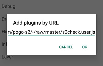

    3. Now download the PoGo S2 plugin (s2check.user.js) and save it somewhere on your device, such as the download folder, or copy it to your phones internal memory using a PC.
    Link: Download PoGo S2 plugin (Updated the link to the Nvlbl Nm fork, as the original version by AlfonsoML has been discontinued)

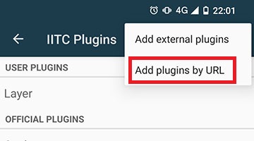

    5. On IITC click the 3 dots in the top right
    6. Go to settings from the 3 dots menu
    7. Click IITC plugins
    8. Click + in the top right hand corner
    9. Use your file manager to find where you saved s2check.user.js you downloaded from the link above, clicking on the plugin to add it to IITC

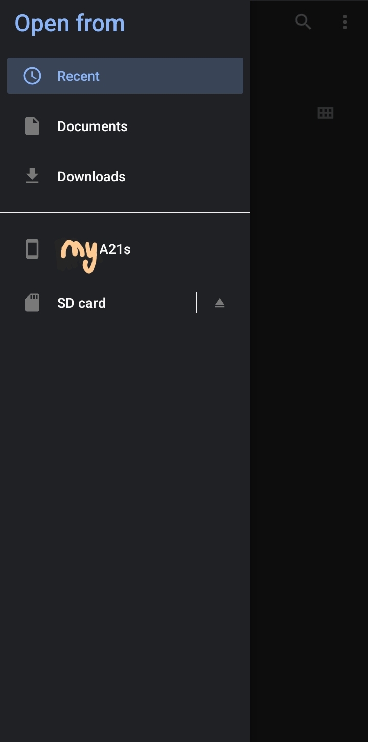

    Note: Some people have had problem selecting the s2check.user.js file on certain Android devices.
    If you find this then i'd recommend you download Fx File Explorer from the Play Store. This is a much more useful file manager that should work better with IITC mobile.
    Once Fx File Explorer is installed you can click the three dots in the top left when browsing for an IITC Mobile plugin, you should then be able to select FX File Choose and select the plugin from your downloads folder without issue:

    I've edited the links to the IITC CE fork as this is still actively developed, in addition i've now linked to the Nvlbl Nm fork of Pogo-Tools s2check.user.js due to the original version by AlfonsoML been discontinued.
    You should use the links in the post above for the latest versions. I've attached a mirror as of 05.05.24 in the event anything happens to either project.

    Ive done this all on an iphone before but ive had trouble doing it on a samsung
    Its the issue mentioned in step 9 which you recommended the fx app to get around, i downloaded the app and was able to manipulate files in it but when it came to using FX File Choose it didnt show up in the open from section,is there some setting in the fx app you have to enable or the settings of the phone to use fx file choose?
