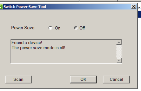

    So if you are having problems with the devices falling asleep, and/or getting error messages when using the tool in the site; download this one and let me know how it goes.

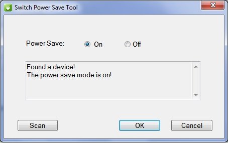

    Hello, I have the power save problem.
    I have the Tp link TL-WPA 4220 Kit, and the problem is the PLC AV500 unit.
    The Switch Save Power Tool does not work:

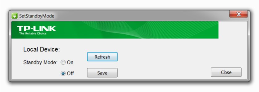

    The latest soft from TP Link, the SetStandbyMode seems to work:
    But it doesn t, no matter what shows the image above, the AV500 unit gets on but after a while it goes into stand by mode.....

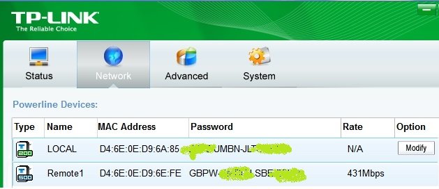

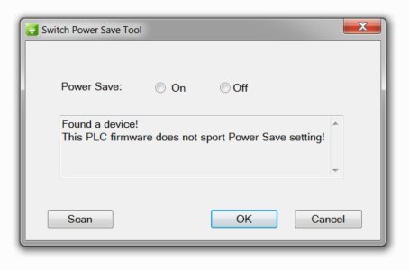

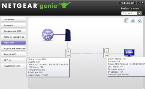

    After a long time working with TP-Link programs and other programs, I was able to see the connection scheme of my adapters (in the attachment).
    These programs did not work either, but I DISABLED BOTH THE ADAPTER FROM THE ELECTRIC NETWORK FOR ONE MINUTE AND TURNED ON AGAIN. Programs work!
    NETGEAR_Powerline_V2.2.27.1_230-10802-07.jpg TL-PA7020P KIT_V1_Utility_20150327_.jpg Switch Power Save Tool.jpg
