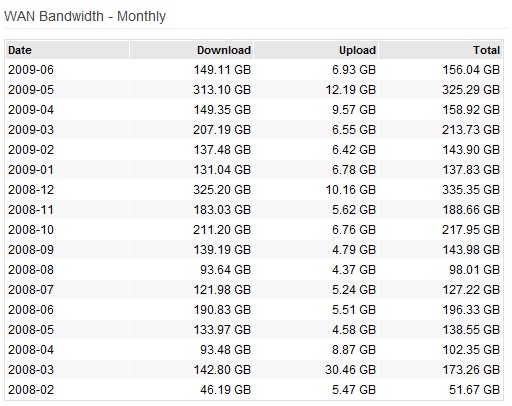

I think it would be better to backup to a remote server such as your Digiex webspace. A dedicated server should be online 24/7, at some point your pc is not going to be on when your router wants to backup the bandwidth logs. (especially as you like installing new Windows 7 builds)
The advantage of doing the bandwidth monitoring with your router is that it will log the bandwidth used by every device on your network and not just a pc running an application to do so, this means the bandwidth used by the 360 and other games consoles will also be logged.
To change when the logs are backed up I think you would find "1 */12 * * * /tmp/backup-rstats" and modify the 12 to 1 for example if you want the backup to run every hour.
The script has been working perfectly for the last 1 and a half years now.

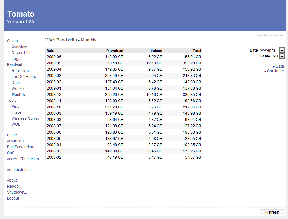

Finally got it working fully today. Of course this picture is mostly showing all your rstats since you sent me yours. Though its backing up once every hour to my user webspace here. which is behind a webpage so no one should be able to see it inless they access it via a ftp client which to my knowledge doesn't work without a user and pass.
Thanks for helping me today on MSN. I turned out leaving the shutdown code as it was and changing the wan up script a little to this. so it replaces the old file on the server instead on creating a new one each time.

As you can see it updated the file on the server at 11:01!!!!! Thanks again!
