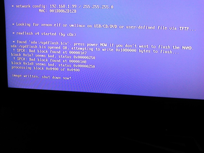

    Power the console on with the eject button. Xell should load. Ensure the network cable it connected, then you should see this
    go to http://192.168.1.99 or what ever your consoles ip address is, you should be able to download your "raw flash".
    Do that and use it as your source nand to build a new image, after that has done flash it to the console and hopefully that should work.

    Nand Flasher 360 was released before the Slim Trinity consoles were hacked, that's why it says unknown for them. It should still dump the nand fine as you have found. If you want to be extra safe follow the directions in this post here: https://digiex.net/guides-reviews/c...rnel-dashboard-14699-xebuild-6.html#post64641 and dump the nand from Xell over the network.
    Also when flashing the new nand i would personally use Xell on a Slim as it will be 100% supported, I can not tell you if Nand Flasher 360 will or wont wortk. To use Xell to flash the new nand just place it on thge Fat32 formatted USB memory stick and call it updflash.bin, Xell should pick it up and flash it then.
    Finally for building your nand i would use xeBuild GUI 2.085 - 16197 GUI Nand Builder for Jtag / RGH Xbox 360 Consoles if your not already. Very simple to both build and flash. It will also build you a nand for the latest dashboard from the update last fall, this tutorial builds a dashboard over a year old.

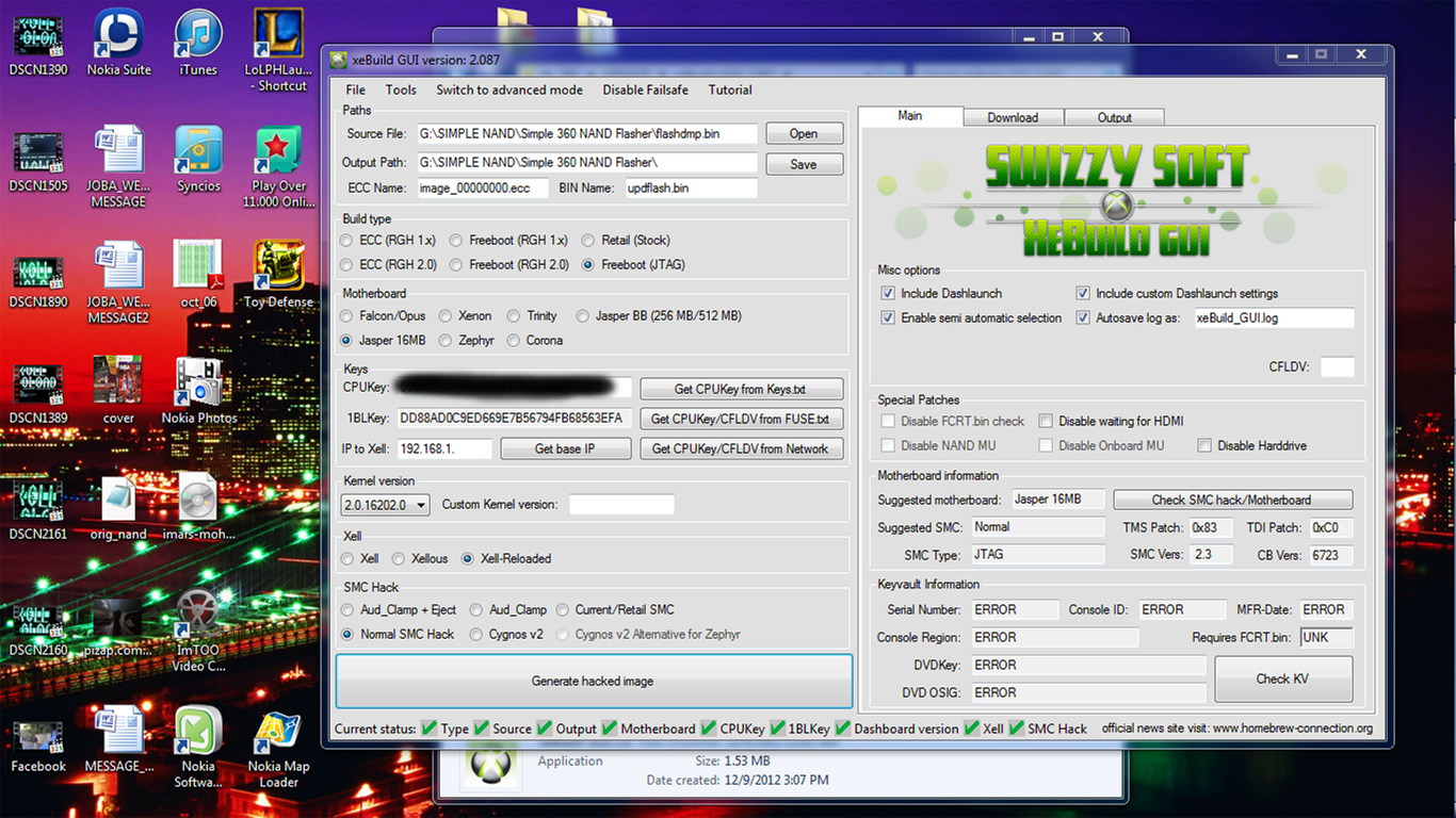

    gud day insane, need your help again, this time its jasper with a wrong dvd drive.. =( (switched it with another unit before, which lost now) everytime i input the cpu key key in xeBuild gui, it says unable to decrypt kv... and the in KEYVAULT INFORMATION says ERROR to all box... im on dash 9199 and want to update it... unit is working fine right now... is it SAFE to GENERATE this in xebuild gui ang write it on xbox 360??? dont use the dvd rom anyway...
  12. InsaneNutter
    12,568
    3,873
    From what you say you might have the wrong CPU key, i would power on the console with the eject button to boot Xell and double check the CPU key, and of course dump the consoles nand at the same same time, since you will need this to update anyway.
    Dont generate a new nand with the incorrect cpu key.

    yup... triple check it actually... isn'tthis because of different dvd drive?? I remember switching its dvd drive before with other console??? heres the screenshot of xeBuild gui pic_xebuild.jpg

    Forgot to add this is what happened when I try to build the nand if it helps
  19. InsaneNutter
    12,568
    3,873
    Use: Xebuild GUI and open a backup of your existing nand, not the original.
    Enter the CPU key and it should do all the hard work for you.
