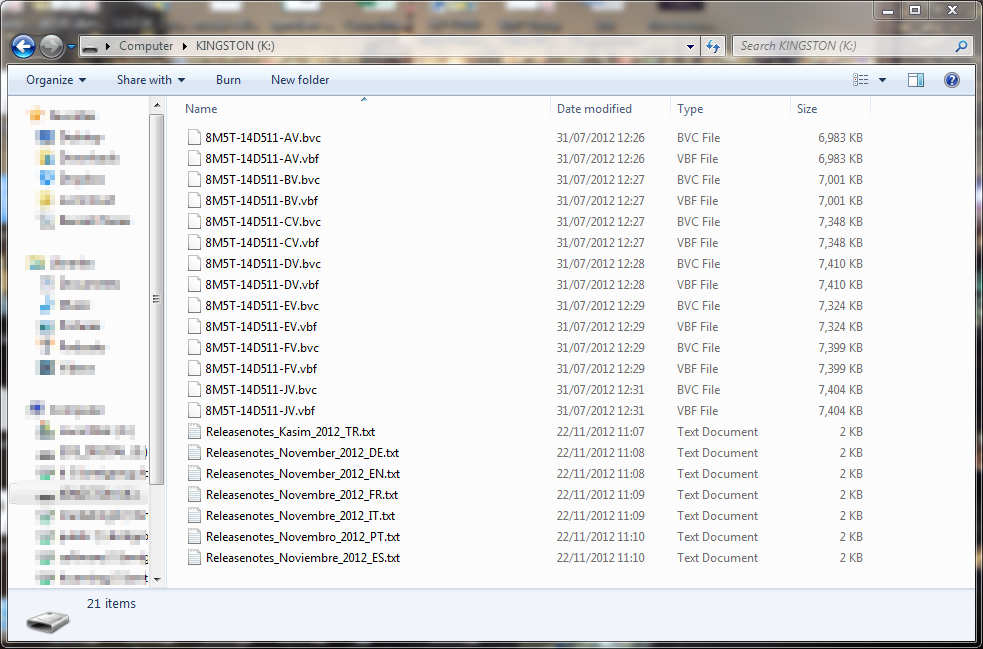

    @Meanderingbunyip is the USB drive FAT32 formatted? at a guess it looks like the car can't read the usb drive so could be NTFS formatted.

    Thanks for the reply. They are fat32 formatted on a MAC. Does that make any difference? I don't own a PC.

    It shouldn't do, its just something that's easily overlooked and could have been what was causing the error. My Macbook Air likes to format to exfat by default.
    Only other thing i can suggest is try a different usb drive, i remember someone had no luck with a usb 3.0 drive, however an older usb 2.0 drive worked perfectly. It should't make a difference, however it did.

    I have a Ford Focus Tit X with a build date of July 11 and had to replace the display screen. Since I've done that I've had no Bluetooth, voice activation and limited USB capabilities so was really pleased when I found this guide. However, I've now tried three seperate USB sticks, the last of which was a SanDisk USB2.0 with 4gb of memory and it still isn't updating.
    I used a Sandisk 8gb first and it was initializing but there were no files and didn't then look as if anything was happening. Tried a Phillips 16gb disk and it said it was incompatible. Lastly tried the 4gb stick and it said no files but again nothing happened.
    Formatted as FAT32 and copied exactly as it says dirextly onto the stick and not in any folders so can't understand why it isnt working.

    Just wanted to say thanks for this! My music was quite crackly, so I'm delighted this has fixed it.
    I had no luck at first with an 8GB USB so tried a different 2GB USB and it worked. Don't think either are USB 3.0, so don't believe that was why the first didn't work. The 2GB USB I chose different settings when formatting to FAT so maybe that was it.
    For anybody wondering I did it on a MacBook running MacOS High Sierra and formatted it to MS-DOS (FAT) under the Master Boot Record (not GUID). Doing this and following the instructions above made it work first time.

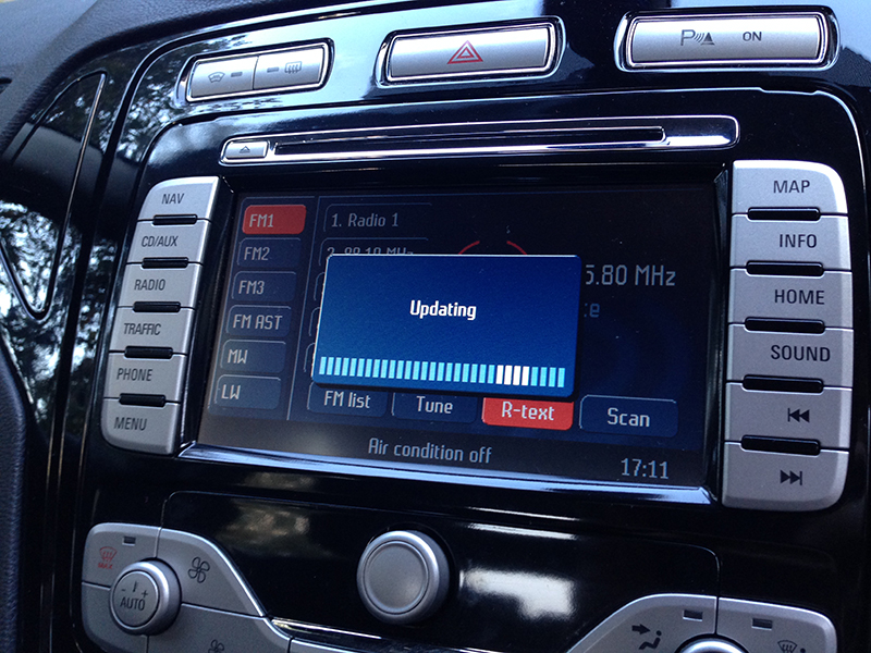

    What happens: when I turn on the ignition, for a split second it seems to start updating but directly it shows an error messGe stating the update didnt work, please try again. And that message keeps appearing when I retry the process.

    I did all the steps exactly the the way you said but it was taking more than an hour my battery is about to die so i just turned off in middle of it.
    After that whenever I turn on the device it always shows “update running please wait”

    I recently bought my first car, a ford fiesta titanium 2008 and I can't connect my Bluetooth via my Sony XZ premium to play music. It connetco for calls but for music, I need to use the AUX. I've followed the advice via updating on a USB stick formatted to fat32 and with the correct files on the USB drive, however when the drive is plugged in, it briefly says "Update running" but then immediately says "update failed, please restart update".
