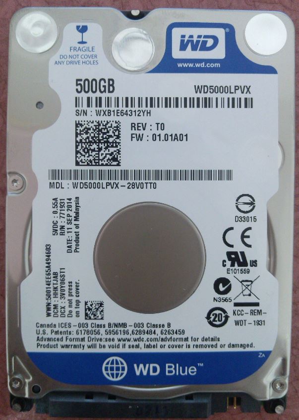

  15. komeil65
    komeil65 New Member
    Oct 3, 2014
    4
    2
    Thanks InsaneNutter
    Successfully hacked WD5000 LPVX - 28V0TT0
      File size:
      87.9 KB
      Views:
      1,478
      File size:
      61.9 KB
      Views:
      1,624
