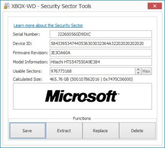

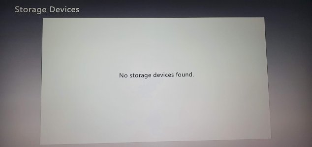

I just used that drive on my 360 and it's not detecting it, can anyone give me some hints?
The previous hard drive I had on my xbox went to hell so I'm starting fresh with this one.
I used the sector info from "HDDSS500.BIN" and flashed it using FATXplorer.
Before I wrote the sectors to the hard drive it was a fully functional drive on Windows, there was nothing wrong with it.

Make sure the drive is properly seated. Turn on the Xbox then push the drive in. If the Xbox doesn't restart then you didn't seat it correctly. If that fails read my comment below.

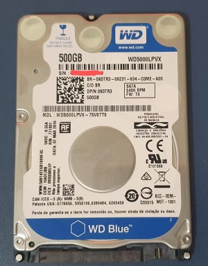

I opted to use a different hdd. WD5000LPCX_VHAT01. It was problematic getting it to work. Originally I flashed it using Rufus with FreeDos and I had errors that occurred despite it saying the drive converted correctly. The UNDO file is unable to revert the HDD so before you buy this drive , keep in mind there is no going backwards. I have the UNDO file still if anyone needs it for reverse testing or something. The other error was about an Invalid Optcode when I attempted to configure partitions. I thought I screenshot the error message but they didn't save.
I found a different USB boot tool here: DOS-on-USB - Free download and software reviews - CNET Download
I tried again using 7.1 version of DOS (6.2 DOS failed for me too, I think. See later part of post). I got a different set of errors messages (though they were similar in context) when I reflashed the drive. However this time after configuring the partitions the process killed itself after the "conversion". I placed the drive in the Xbox and it wasn't showing up (this is a common issue people are reporting). I reached inside the Xbox and realized the HDD wasn't seated very well. I left he Xbox one and wiggled it around a bit until it clicked and the Xbox rebooted. It reported the drive was 88GB free of my 460. I reformatted the drive (entered the key) and everything was working fine. At that point I removed the drive and restored Partition2 using Xtreme in Admin mode.
If you're drive isn't showing up, try leaving the machine on then putting the drive in. It's not good practice but it's a good way to confirm your drive seated correctly.
