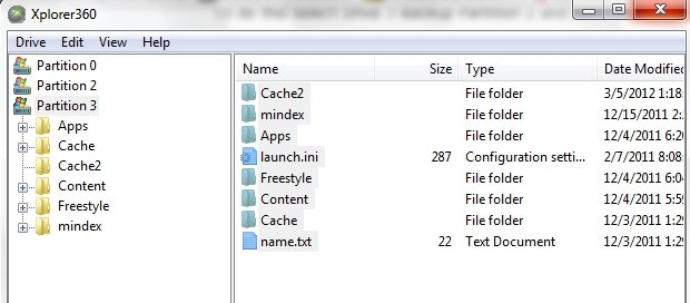

Okay, I ran Xplorer 360 Extreme and backed up Partition 2. But I have attached a file showing what I have in partition 3 of my original HDD which obviously includes FSD, etc. How do I copy these folders because all I see Xplorer 360 Extreme menu is the following:
Open
Close
Backup image
Restore image
Backup partition 2
Restore partition 2
Should I use Backup image and copy everything in partition 3 and then restore partition 2 (using Restore partition 2) and 3 (using Restore image) using Xplorer 360 Extreme 2 for both restores? I'm kind of stuck here and don't want to hose this up.
Also, just for grins, device manager sees the original 360 HDD drive but Windows Explorer does not. That doesn't appear to matter because Xplorer 360 Extreme did successfully backup partition 2.
Thanks,
outofwork

I decided to experiment to see if I could copy the folders in partition 3 by dragging and dropping and everything went fine until I tried to copy the Freestyle folder. Several folders prior to that copied fine using drag and drop into a Windows Explorer window. But after the Freestyle copy was running for several minutes I get the following error message:
Error!
Failed to create the destination folder in recursive dump operation!
Xplorer Extreme seems to hang in a loop following that error message.
Any ideas?
Thanks,
outofwork

This should answer some questions.
Xplorer360 extreme is only used for restoring/backing up partition 2 and for 20gb drives partition 3
xplorer360 has versions for the other size drives also
It is important you just close Xplorer360 after that, massing about with anything else will corrupt Partition 3.
Now Download Xplorer 360 250gb Edition, this works fine with Partition 3 on 250gig drives, however trying to modify anything on partition 0 or 2 will just corrupt the drive!! Trust me save yourself some time and don’t do it.
If you are hacking a 320gb drive then you want to Download Xplorer 360 320gb Edition.
Also don’t use Xplorer 250gig edition on any other sized drive either, it will just corrupt the drive, same with the 320gig edition.
If you do corrupt you drive just connect it to your Xbox 360 and format it.
