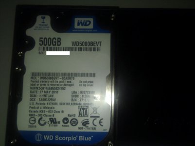

  20. dxdy
    dxdy Member
    Oct 3, 2012
    6
    4
    Here is Undo.bin from my hard drive WD5000BEVT (WD Scorpio Blue)
    Michael_T, InsaneNutter and Rick like this.
