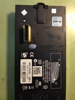

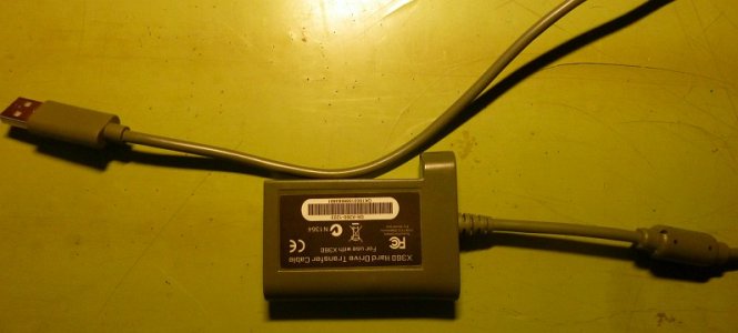

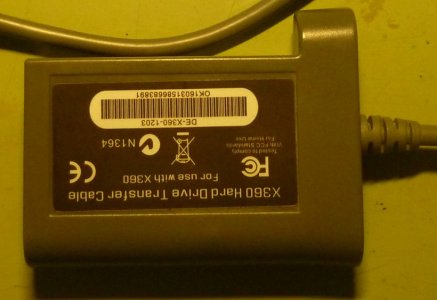

I got the cable from an Amazon seller with good reviews. See attached. Can you tell if this is good?
