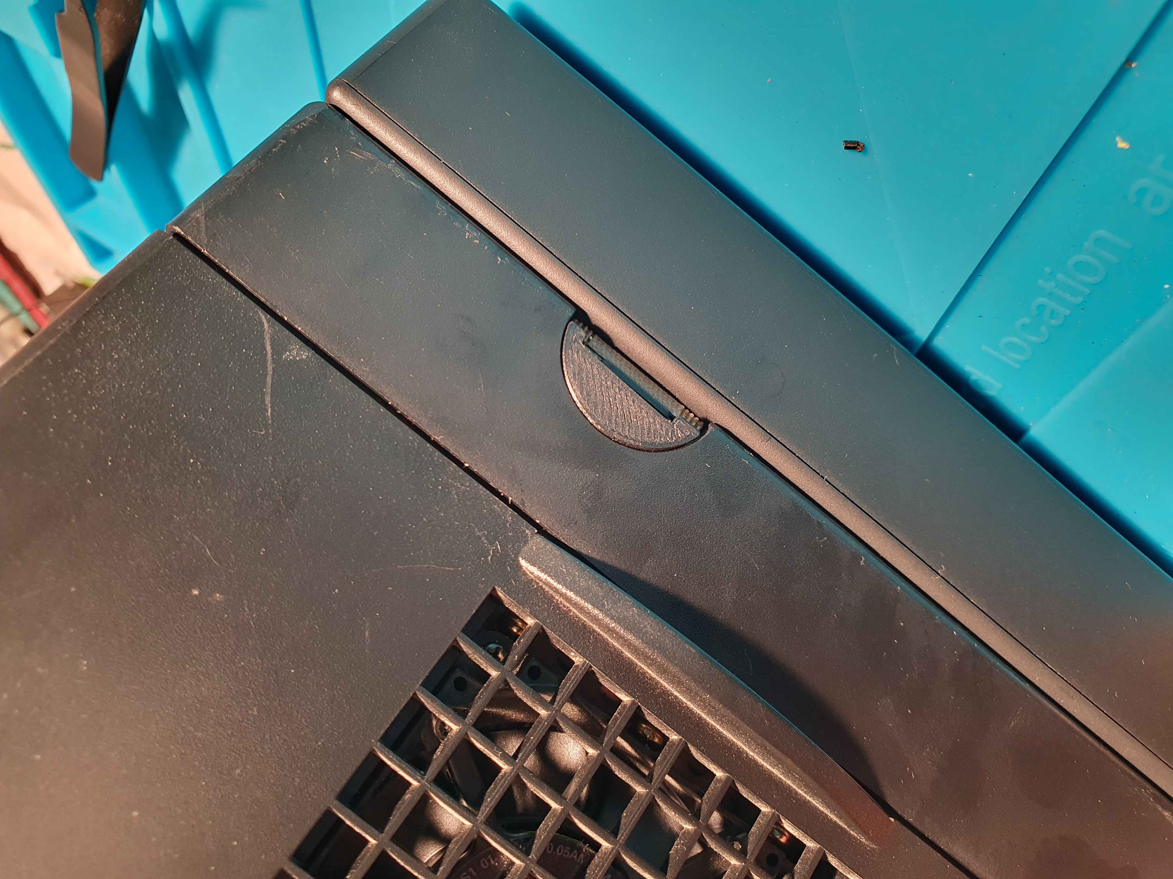

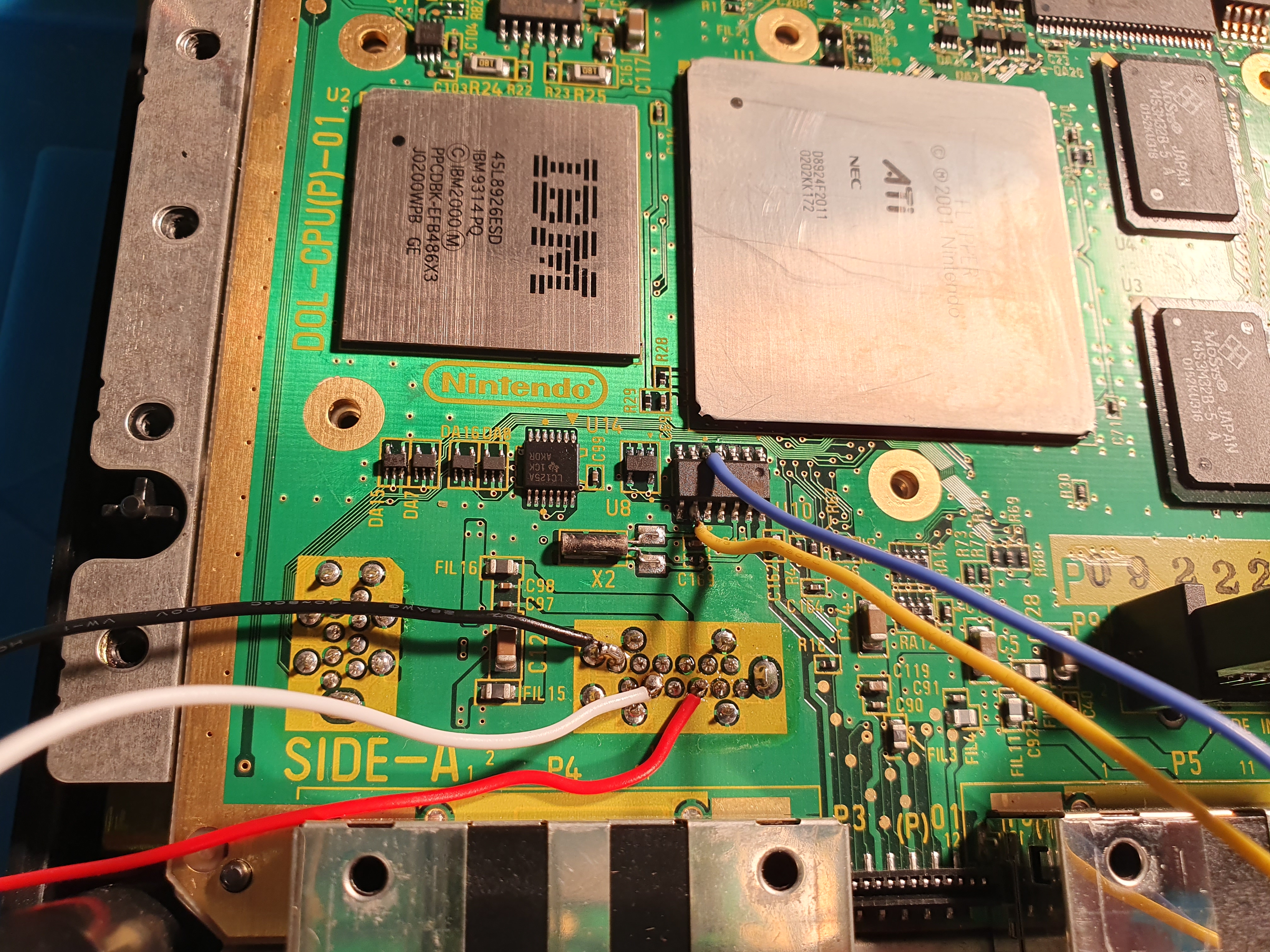

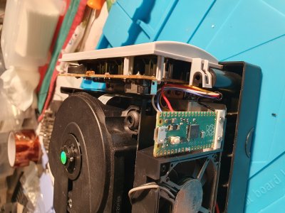

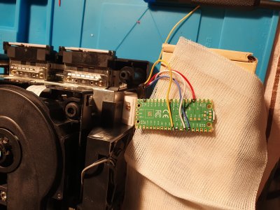

    After a long time the mod came out, I finally attempted to install PicoBoot on my GameCube.
    I followed the official guide here.
    Here there are my suggestions:
    • I have some soldering experience but I'm not a true expert. I can say that this mod needs some experience. It isn't very hard, but it can't be your first soldering work.
    • The main developer recommends stranded wires, I personally prefer solid wires because they are easier to solder (I used 28AWG solid wires).

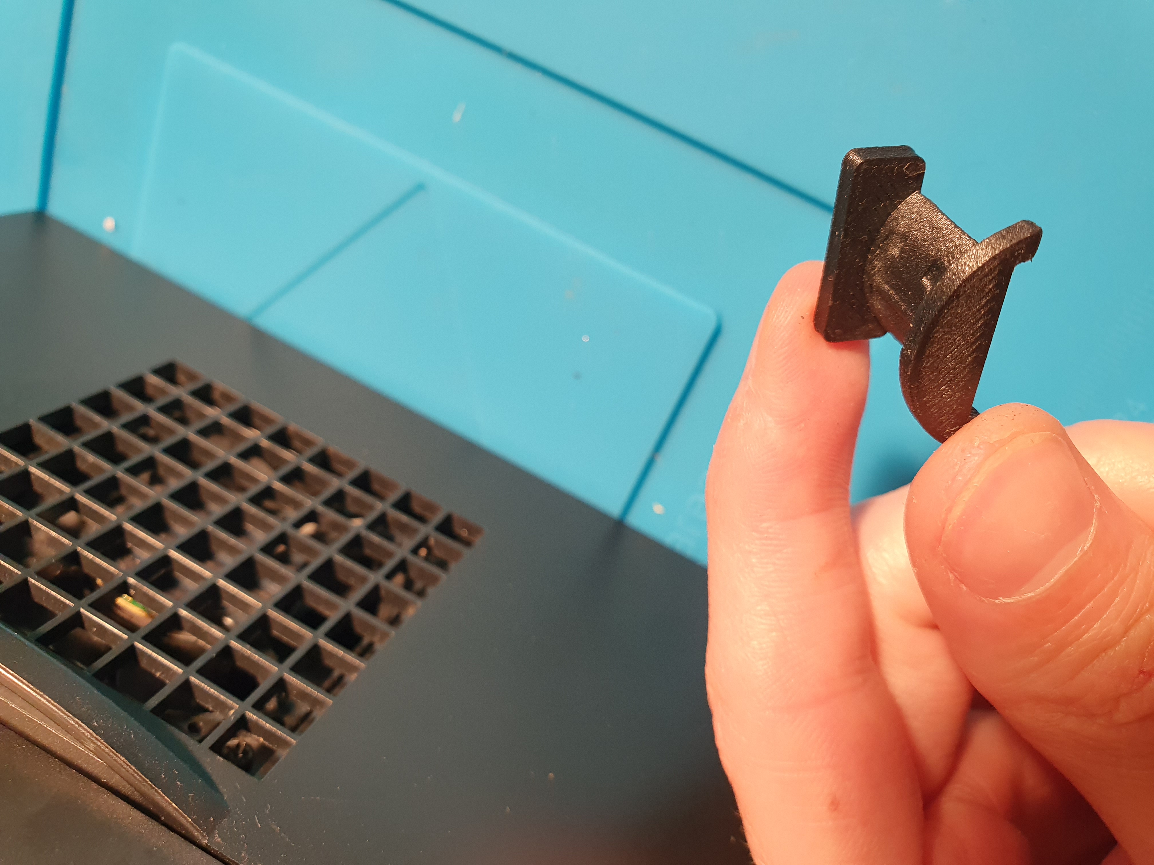

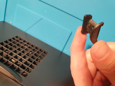

    • The best option to place your Pico board is near the vent using this 3D printed stand (you need two screws 2mm diameter).

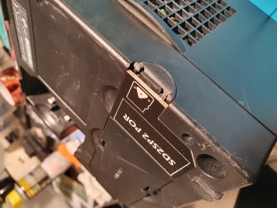

    • If you own a Game Boy Player, or if you simply want a more accessible SD card, I suggest the SD2SP2 POR (PRO). You can fill the gap between the SD card slot and the GameCube chassis with this 3D printed cover.
    • I suggest FAT32 SD card. PicoBoot works also with exFAT, but a lot of Homebrews (like GCMM) works only with FAT32 and a lot of .ISO works better with FAT32.
    • If you use an old model of GCVideo HDMI adapter (like previous version of Kaico HDMI adapter), I suggest this 3D printed Support Brace in order to support the dongle from sagging.

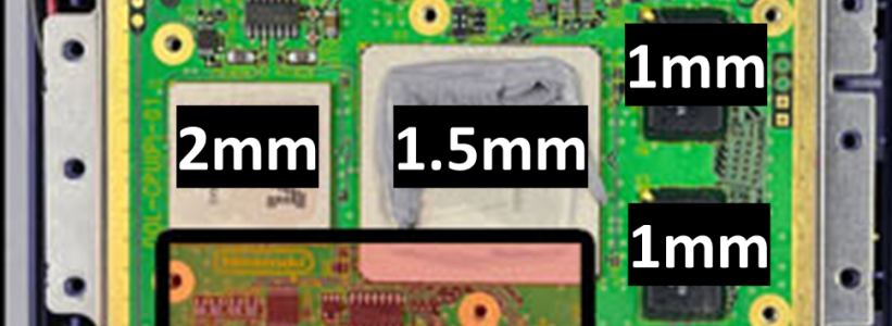

    • During the work, I replaced the thermal pads. If you want to do the same here there are the thickness:
    Here there are some pictures:
    IMG_20240425_103010_516.jpg IMG_20240425_103010_393.jpg IMG_20240425_103010_822.jpg IMG_20240425_103011_306.jpg IMG_20240425_103011_049.jpg IMG_20240425_103011_539.jpg

    Nice work on the installation, that looks like a good install. Did you 3D print the stand yourself also?
    The Raspberry Pi Pico really has become almost a universal modchip of sorts, interesting to see all the projects that has been used in.

    Yep, I 3Dprinted the stand with the helping of a friend who owns a 3D printer (I should buy one myself sooner or later).
    I still keep the GameCube in my entertainment system because of the Game Boy Player. All my Wii stuffs are copied in my Wii U, so at the moment I keep Switch, Wii U and GameCube (my Wii is safe in a box).
