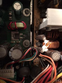

    Removing the original drive, however, exposed the next potential problem - old, leaking capacitors.
    Is there a cheap way to fix this (assuming I have a friend with a soldering iron)? If so, will I need to remove the motherboard and completely disassemble the box?
    Choice two, of course, is to ignore it until it dies - it's lasted this long and worked, it's not going to be in use all that often.
