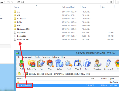

    2. Download the Gateway Launcher
    3. Unzip this to the root of your 3DS's SD card
    4. You are now ready to dump your 3DS's nand, ensure you have at least 1gb of free space on the 3DS's SD card.
