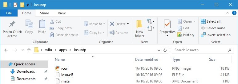

    If you do not already have the homebrew app IOSuOTP on your SD card then simply download IOSuOTP and unzip it to your SD Card.
    You should now have an iosuotp folder on your Wii U's SD card in the wiiu\apps folder, which contains the required .elf to load iosuotp:

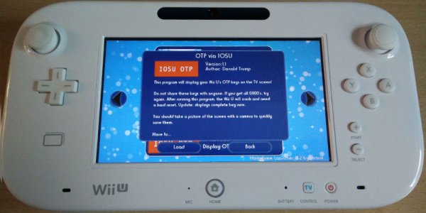

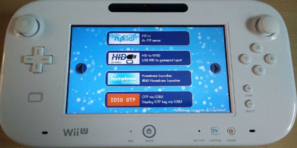

    You now simply want to load IOSU OTP from the homebrew launcher menu:

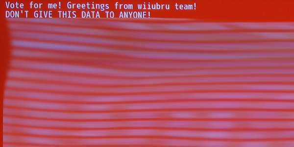

    The Wii U will have now crashed, however you consoles unique OTP will be displayed on the TV.
    Photograph this for safe keeping and don't share the photo with anyone.
    If all you see is 00000000 then the OTP has failed to be extracted, simply power the the Wii U and try again.
