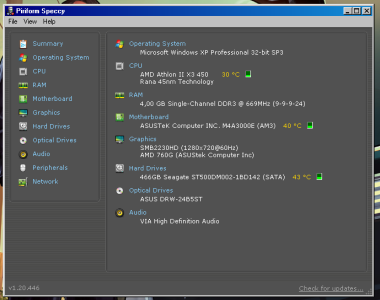

    Here are my low budget pc specs as i game on the 360 & PS3 anyway.
