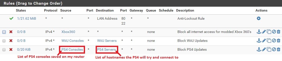

    How Did I Block My PS4 From Accessing The PSN On My Router?
    First I have my router set to assign my PS4 a static IP address, this means my PS4 will always have the same IP address on my network. I have then added the PS4's IP address on my local network to an list (alias) called PS4 consoles.
    I have then created another list which contains all the host names for the PSN above, this is called PS4 Servers.
    Finally I have created a rule which blocks all IPV4 traffic from the PS4 Consoles going to the PS4 servers, as can be seen below:
    The end result is my PS4 still has internet access, it just can't talk to Sony's servers.
    I'm using pfSense as my router / firewall, this can run on an old PC with two network cards. pfSense can be downloaded for free here: pfSense download
