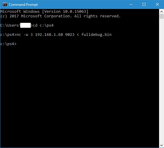

    Now open a Command Prompt and type cd c:\ps4 if you unzipped the nc.exe and fulldebug.bin files to a ps4 folder on the root of your C:\ drive
    Type in the Command Prompt window:
    nc -w 3 192.168.1.68 9023 < fulldebug.bin
    • 192.168.1.68 - This is the ip address of your PS4, you can find this out from Settings > Network on the PS4 if you don't already know it.
    • fulldebug = this is the .bin payload you wish to the PS4 to load
    Press enter and the payload should be sent to the PS4 and loaded as you can see below:
    That's it you have learned how to send a .bin payload to an exploitable PS4 on the 1.76 firmware.
