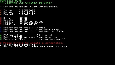

  9. SCD
    SCD New Member
    Feb 19, 2014
    2
    Hi there! thanks for making such a clear and easy-to use guide :) I do, however, have some problems.
    From what I've been able to gather from what has been said before, I should have no problems running the CIPL flasher. Whenever I do though, I get the message "this installer does not support this model" and I'm bumped back to the PSP menu. Is this solvable or do I just have to go with fast recovery?
  10. InsaneNutter
    12,318
    3,742
    You have a E1000 model, so unfortunately you cannot permanently flash custom firmware. That is only possible on some really old PSP models. You will have to run the fast recovery when you fully power the PSP off.
  11. SCD
    SCD New Member
    Feb 19, 2014
    2
    Ah, I thought as much. Thanks for the quick reply!
    EDIT: I've hit another hurdle! I've been trying to enable a cheat engine, and the instructions I've been following call for me to turn off the console and hold R to enter recovery mode, in order to enable the plugins. This guide recommends 4.01 M33-2 for the firmware, so I've wondering if 6.60 PRO-C2 has a different method of enabling recovery mode? Or am I unable to enter recovery mode at all, due to being unable to permanently install the firmware?
    EDIT 2: never fear, got it to work. Turns out I could get to recovery mode by holding select on the main menu. Now I just have to work out how to get the cheats themselves working.

    ok additional info from my screenshot. says motherboard is TA-090 v2
    its a bright 3001 (03g)
    psp version is bright v1.0
    read only on what i think means battery
    possible cfw 5.03 HEN and up
