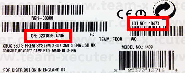

    Not all new slims can be hacked without problems, for example if you get one with the Lite-On 1175 dvd drive that can not be hacked, the newer slims can also not be RGH hacked.
    For slims you can look at the lot number on the box to try identify what drive is in the console before buying:
    1143X Mix of Hitachi 0500 & 1175
    1142X Mix of Hitachi 0500 & 1175
    1141X Mix of 0401/1071 & 1175
    113XX Mix of Hitachi 0500 & 1175
    1119X All 1071
    1118X All 1071
    1123X Mix of 0225 and 1071
    1102x All Hitachi 0500
    1114X All 0401
    11XXX All 0225
    104XX Mix of 9504 and 0225. Mostly 0225. High Probability that a 9504 is a mislabeled 0225
    103XX Mix of 9504 and 0225 - mostly 9504
    102XX All 9504
    101XX All 9504
    104X All 9504
    Here you can see which drives have hacked firmware, and which are in the process of been hacked at the moment: c4eva Speaks! | automated irc logs, updated instantly whenever and wherever c4eva speaks
