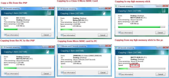

    I’ve noticed when copying files big files I always get quicker speeds compared to very small files, never really looked in to why this is. If you can write at 4MB to the memory stick that’s not too bad.
    I can read from my PSP at 4MB and write to it at 2.50MB, I tested the micro sdhc card in my phone along with my 8gb usb pen drive and the PSP is by far the slowest device. (see atatched image)
    As you can get speeds greater than 1MB (about 11mbps) usb 2 must be enabled.
