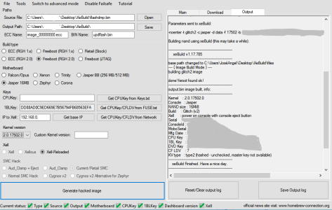

I followed your tut from top to bottom. i have a Jasper v4 16MB NAND with RGH (checked via DashLaunch).
1) I extracted the raw Flash via my web browser and the console's IP address.
2) I used this to create my new nand with XeBuild 2.098 (the set up i used is in the screenshots below. Since i had an RGH i selected Freebot (RGH 2.0))
3) I checked my console's CPU key and put it in XeBuild
4) I generated the new image file, no errors were found in the process.
5) I booted into Xell, and flashed the new image file.
6) unplugged the console's power cable and waited for 3-4 minutes
7) plugged in and booted console
the system just lights the Power button, but nothing happens, it just stays there forever!!.:'(:'( i tried booting into Xell via the Eject button, but nothing happens either. it just stays on but no boot sequence/screen ever appears.
What did i do wrong? what can i do to fix this? I have my Raw flash and the nand extracted via Nand Flasher 360 (Did this just in case). Thanks in advance for your help
When selecting your dumped nand as a source did it automatically determine you had a Freeboot RGH 2.0 or did you just guess this?
The reason I ask is that their are a couple of variations of the RGH hack, if XeBuild had determined you had a certain version of the hack, then you selected a different version that would cause things not to work.
You need a hardware nand flasher to flash a working nand back to the Xbox 360 now, such as the Nand X. You solder this to certain points on the motherboard, this allows you to flash the Xbox 360's nand via USB, so you can restore the backup of the nand you made.
