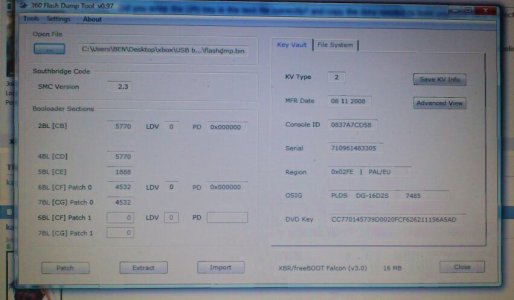

    Hey masterchief this is what cam up when i put the flashdmp.bin into flash360
