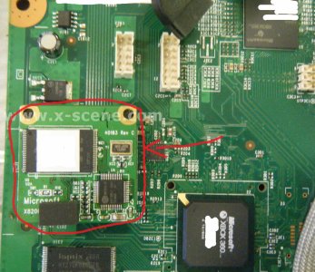

  18. mosheva
    mosheva Member
    Jan 26, 2011
    23
    Hello again!
    I know this post is a bit old but I have some update...
    I saw that on the 4gb slim M$ is adding a 4gb PCB chip while in the 250 version they don't... I opened my slim detached the 4gb PCB and now it's all good!
    Just wanna let you know and for someone I guess one in a million that had this problem...
    here is the motherboard with the 4 gb PCB
  19. Corona
    Corona Addict
    Sep 1, 2010
    575
    169
    put it back in and format the device that should work or the card may be bad. if you need a new one i have one for 20 bucks so pm if ya want
