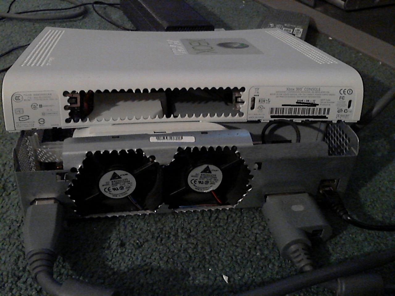

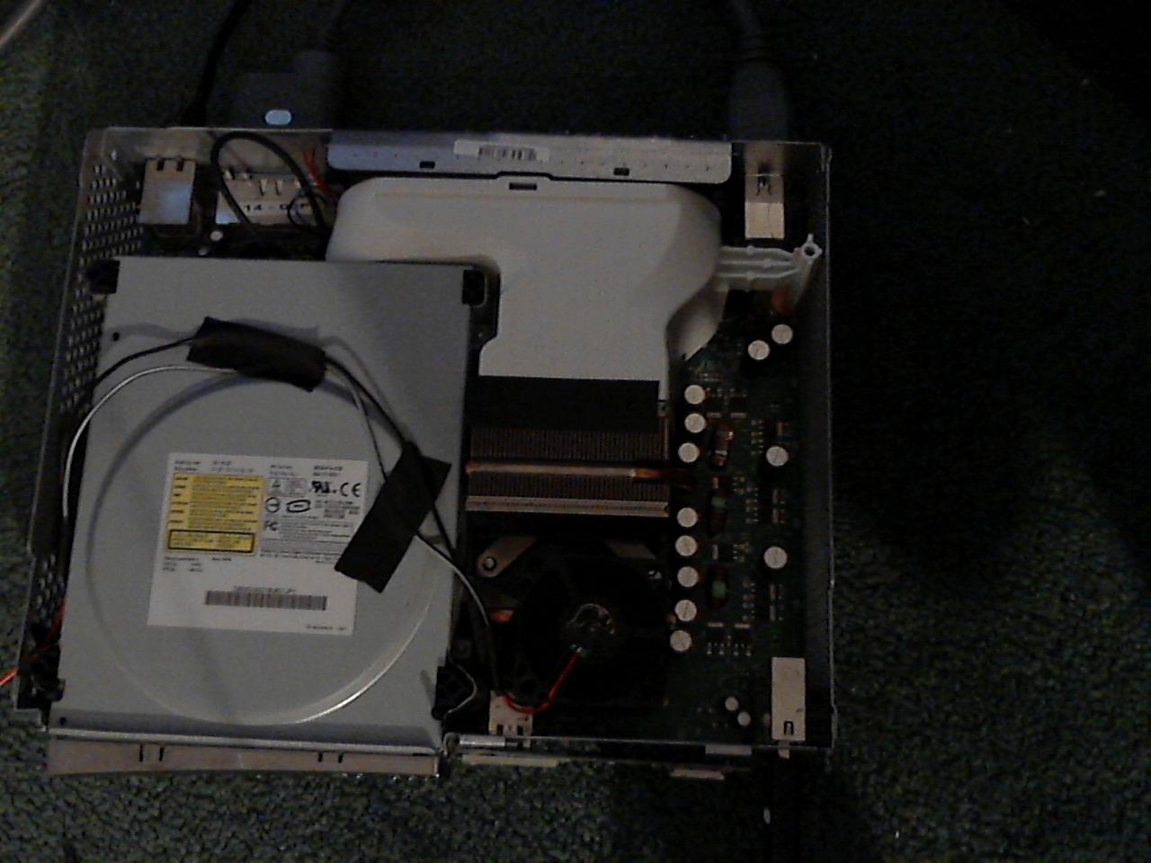

This seems to work good.I have a fan over the heatsink that bridges to the gpu heatsink.Its wired up to a battery charger.I also cut the back grid.(see images)
