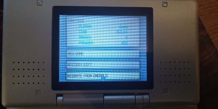

    Do you have a 4th gen game you can attempt to transfer some emerald pokemon to? You may have a fake copy of emerald. A sure way to check it is attempting to transfer. Fun fact you could use a flash cart for the 4th gen game to test it.
  9. bamboodle_poodle
    bamboodle_poodle Member
    Oct 10, 2023
    5
    2
    Thanks for the response. I used to have an R4 but I gave it away in 2014. I purchased Emerald brand new over 16 years ago at this point and I've Pal Parked guys from it considerably over the years. However, that'd be great insight if that wasn't the case.

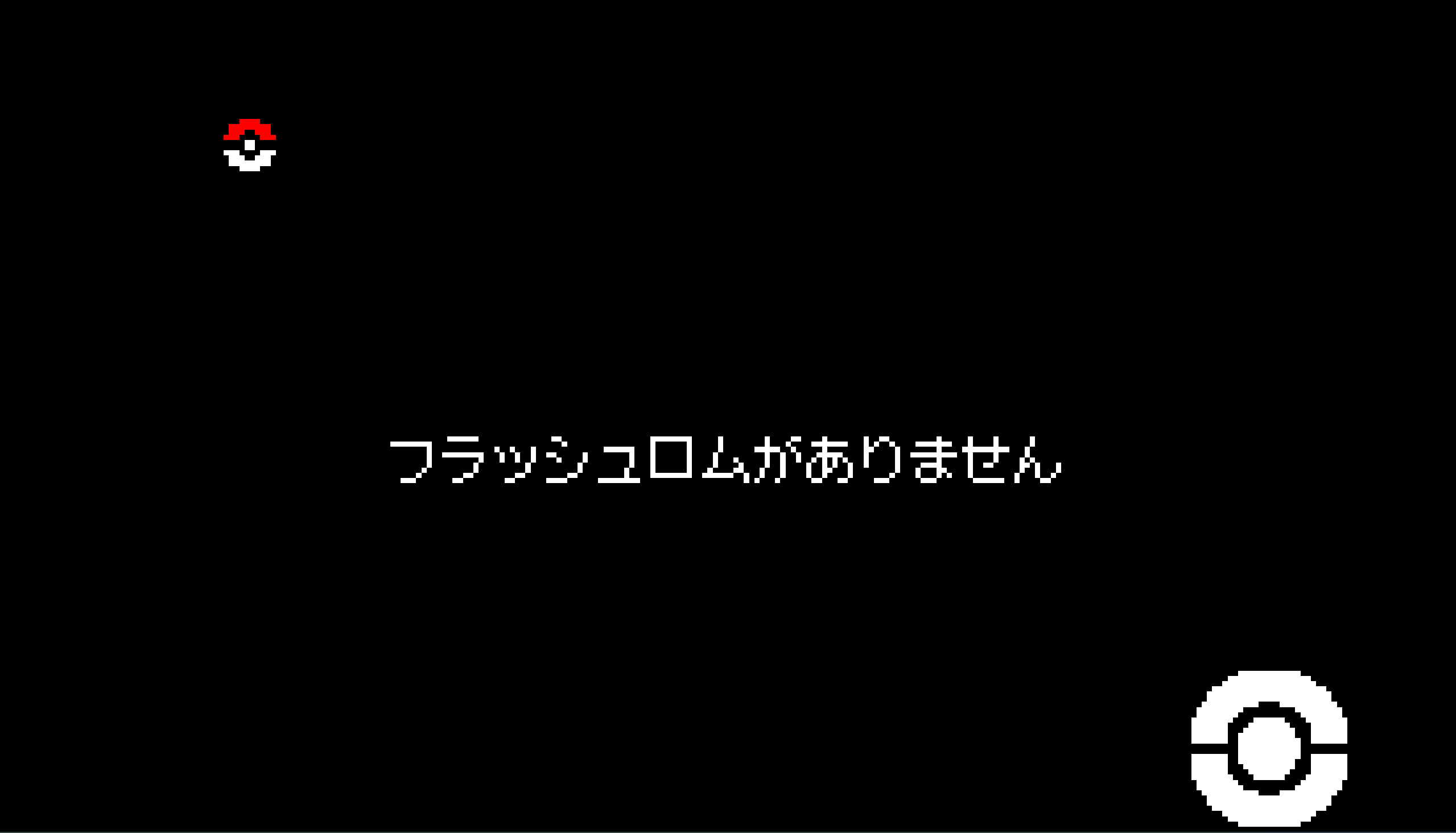

    Hi all, I recently got into the scene and came across this event however it's giving me troubles on EZ Flash Omega. I originally had the Japanese text issue saying no flash rom, which going through this thread found that the file needed to be patched, doing an SRAM patch like suggested gave me the correct text but it will still not send to my AUS Firered. I have booted an unpatched/ patched no date, date versions of the rom but still get nothing on the receiving GBA. I have a free slot in the party but it's still perplexing. I also ensured that it was clean boot with 128Flash selected. Anyone able to aid troubleshooting this issue?
  18. captain_snack
    captain_snack New Member
    Feb 17, 2025
    2
    Fixed the issue. The sender (distribution cart/ EZ Flash) needs to be player 1 with the official link cable and player 2 being the receiver.
