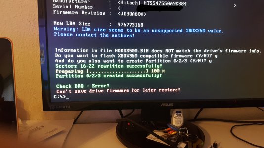

    Hello, i have hts547550a9e384 500gb HDD i don't exactly remember where i got this but it working perfectly with my PC
    i tried to apply 500gb Firmware for this HDD and USE hddhackr to reconfigure this HHD for my Xbox 360 Slim but i got this message may be some body may help me to configure it for my xbox,
    Without any configurations Xbox can't see this HDD.
    May be i ma doing something wrong...
    I am working with Windows 10 will be happy to se solution for it.... because almost all old programs not working under 10..
    Thanks!

    Hddhackr will only work with western digital hard drives, you can't hack any other brand of drive unfortunately.

    if rightly understand i no need any hack i need just recreate partitions 0/2/3, do u have any manual for this? Thank you!

    Format the hard drive from the Xbox 360, it will create the partitions when you do so. That would be the easiest way to do what you want to.
    The only manual for hddhackr is the read me it comes with.
