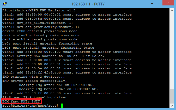

    To enable Fast-Nat on your Tomato powered router type modprobe bcm_nat
    To confirm Fast-Nat is enabled type dmesg and you should see "BCM fast NAT: INIT" if fast nat has been enabled:
    Every time the router is rebooted you will need to re enable fast nat, the most simple way to do this without any user intervention is to enter BCM fast NAT: INIT in to the routers Init script.
