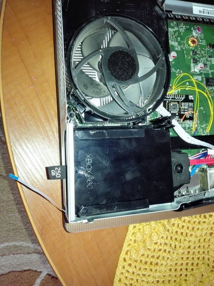

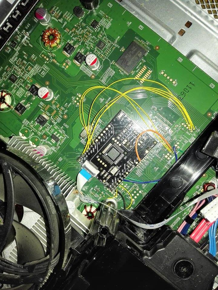

    I'm not really familiar with this stuff, but there's this lil cable coming out of the chip, any use of it to me?
  7. InsaneNutter
    12,518
    3,855
    Yes, it looks like your console is RGH hacked, that chip performs that hack that allows your console to power on. Don't go pulling any wires out of it.
  8. Astravanger
    Astravanger Member
    Sep 25, 2015
    6
    No no no, I mean the little white flat cable that comes out where the HDD is in, and it comes out of the chip RGH chip.
  9. InsaneNutter
    12,518
    3,855
    Is it connected to something? I'd personally just leave it as is.
