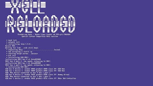

Power on the console with the eject button, do you see Xell on screen? It will look something like this: Try with the switch flipped both ways and see what happens? the console could have a dual nand setup.
Thanks for trying to help out! Ok tried that. Led/switch off : still boots into update screen and then error code Led/switch on : nothing on screen, but power button flashed red The switch on top has an USB male connect output next to it.as if I could plug an external 2.5" drive directly to it without a cable. Console is connected to the TV using the RGB cables. Any help would be appreciated, there are 1 or 2 kids who would love to play on this console.
From what you have said it appears the console has a dual nand mod and a flashed DVD drive. When the switch is off that loads the Xbox 360 up as normal so it can connect to Xbox Live (presuming its not banned) however the DVD drive has been flashed with some alternate firmware so the Xbox 360 can play burned games. When the switch is on the console would have loaded up in to a hacked system which cant connect to Xbox Live, however is capable of running homebrew, emulators and so on. It appears this nand has been messed up. The problem you have is you have nothing that was backed up when the console is modded. If you open the console up and look at the DVD drive you can find out what model / firmware it has, you can then flash that back to the stock Microsoft firmware. That should then allow the console to update. Chances are you would have to invest in hardware to do this depending on the DVD drive in the console.
