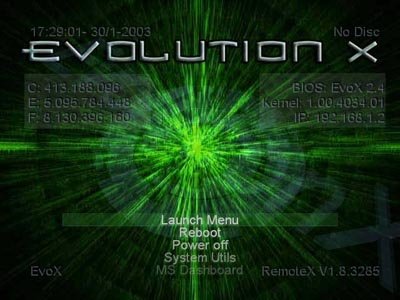

evox1.jpg​
Evolution-X was one of the first Xbox dashboards to incorporate in-game reset, activated by pushing down four buttons simultaneously on the joypad (Back, Start or Black, Left trigger, and Right trigger), which is now a feature available in every dashboard today. It is also highly customizable, allowing the user to set their own menu structure by modifying the Evox.ini configuration file and use custom skins which change the visual style of the dashboard and choose what system information it should display.

I am net here and new to consoles too. I was recently given an original Xbox when I told a friend that I think it's cool when people mod them and use them for emulators. I have figure out how to soft mod it, and I have it booting to Evolution X 3935(which is why I am starting here.) I could use some help figuring out the initial "how to" stuff. For example, if I load an emulator by FTP, how do I get it to appear In the menu under Emulators?
I would also like to know how boot to another dashboard, like XBMC, if I choose to.
I think you need to FTP emulators in to E:\Emus for them to show under emulators on the evox dashboard.
To change the dashboard you would need to boot another app / dashboard from your apps folder, which has an FTP server.
Then simply delete evolution x and replace it with xbmc, ensuring the default.xbe end up in the same folder.
The default.xbe needs to be signed though depending on the exploit the console has been modded with. What i have done on friends Xbox's is sign a default xbe which is essentially a shortcut to E:\Apps\xbmc\default.xbe
So E:\dashboard\default.xbe can stay there and i can update XBMC which resides in E:\Apps\xbmc\ as and when i please without worrying if i need to sign an xbe or not. I can certainly go in to more detail if you decide to do this and provide my signed default.xbe shortcut when i'm at home if required.
That's what i did well over 10 years ago, if that's still the best way today i honestly couldn't say. However the various Xbox's i did softmod still work all these years later.
