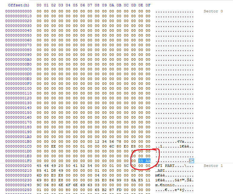

if you are having Trouble use a hex editor its really simple to use. Just fellow the pictures i have uploaded you change the 55CC to 99AA where the highlighted section is and save it will give you and error regarding you could damage this but i have never had any issues
You now unplug and plug the drive in and it will load as a windows formated drive back up you files as you want. To revert back to a xbox one format repeat the process but changing the highlighted section back to 55CC save unplug and plug back into the pc load your hex editor and go to to sector 20 and make sure you change this number back to 2 if not the xbox will read the drive but read it as empty
sorry if its not the best this is my 1st post but had to help as i had the same issue for months untill i gave up and started messing with hex editior on my drives to solve this Hopes this helps
about offset 1FD and 1FF
So , XBOX ONE drive need to be = 55CC ?
PC = 99AA ?
I checked one of my drives and I have 99CC , any comments ?
btw my old drive I used on xbox one was MBR drive , it stop to work after one of the last updates , I converted it to GPT and it working ok now , data is not lost .

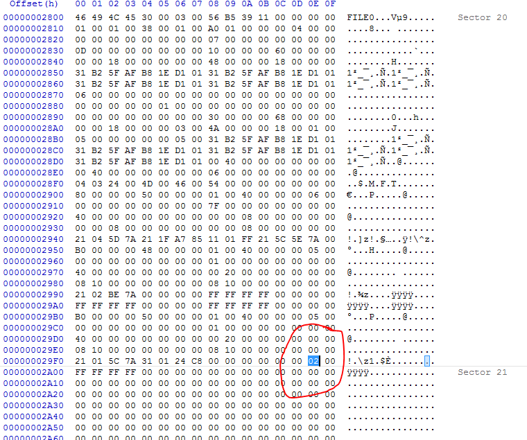

about offset 29FE ( Sector 20 ) I have "03" there , you say it need to be "02" ? what number was there before you edit to "02" ?
