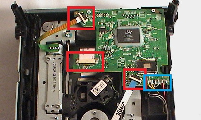

I have another console which does have HDMI, also 203 power supply. But it's DVD is broken. I tried replacing it with a Hitachi (won't read game discs, but reads standard DVD) and then a Samsung (attempts to read game discs, then shows the play on xbox 360 screen).
You will need the same drive model as the one with hdmi.Then swap the pcb boards, you might have to unsolder and solder some wires.

I have edited a picture below.
With the red boxes,(ribbon cables) you want to disconnect those just push the plastic holders back, for the blue box you have solder those cables off then solder it to the replacement drive.Make sure to solder them in the right order.
edit:
Each drive is assigned to one console only, replacing the pcb is the only way to have a replacement drive work on that console.
