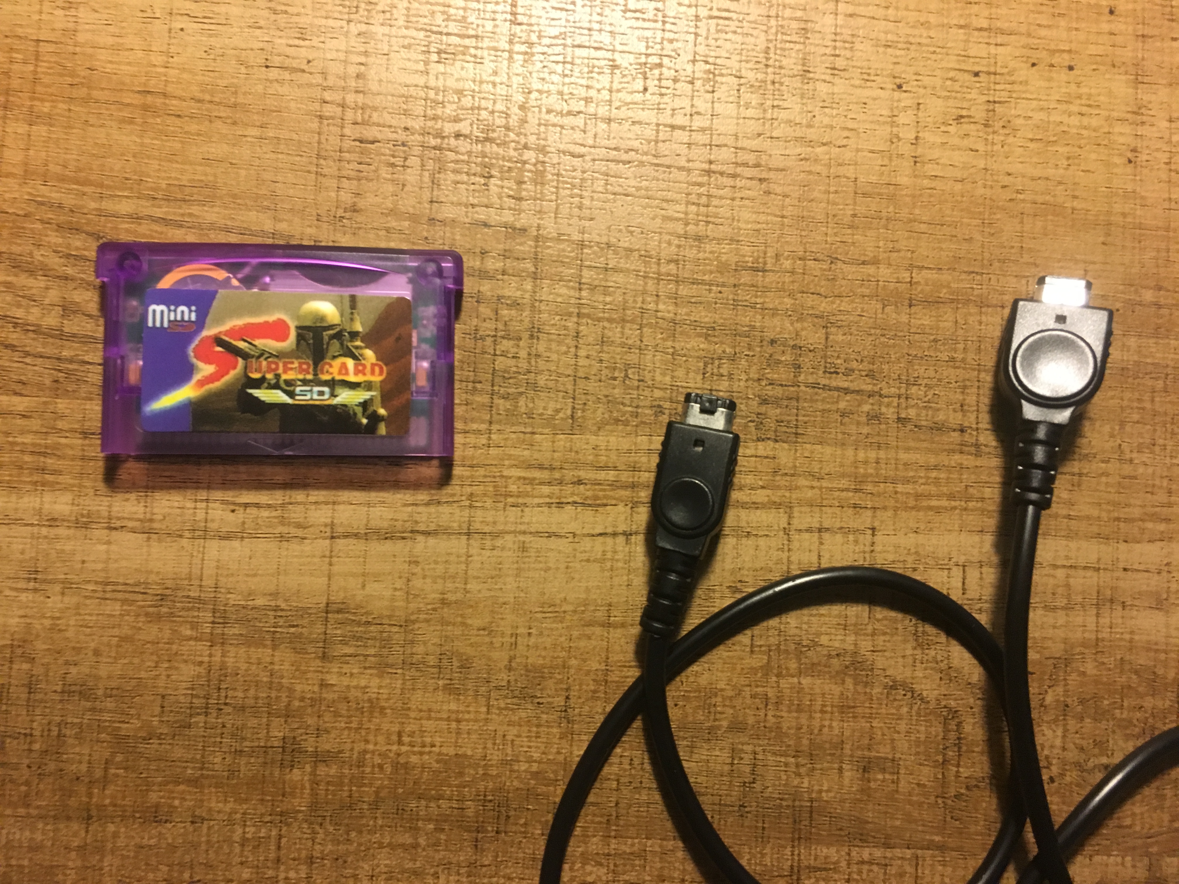

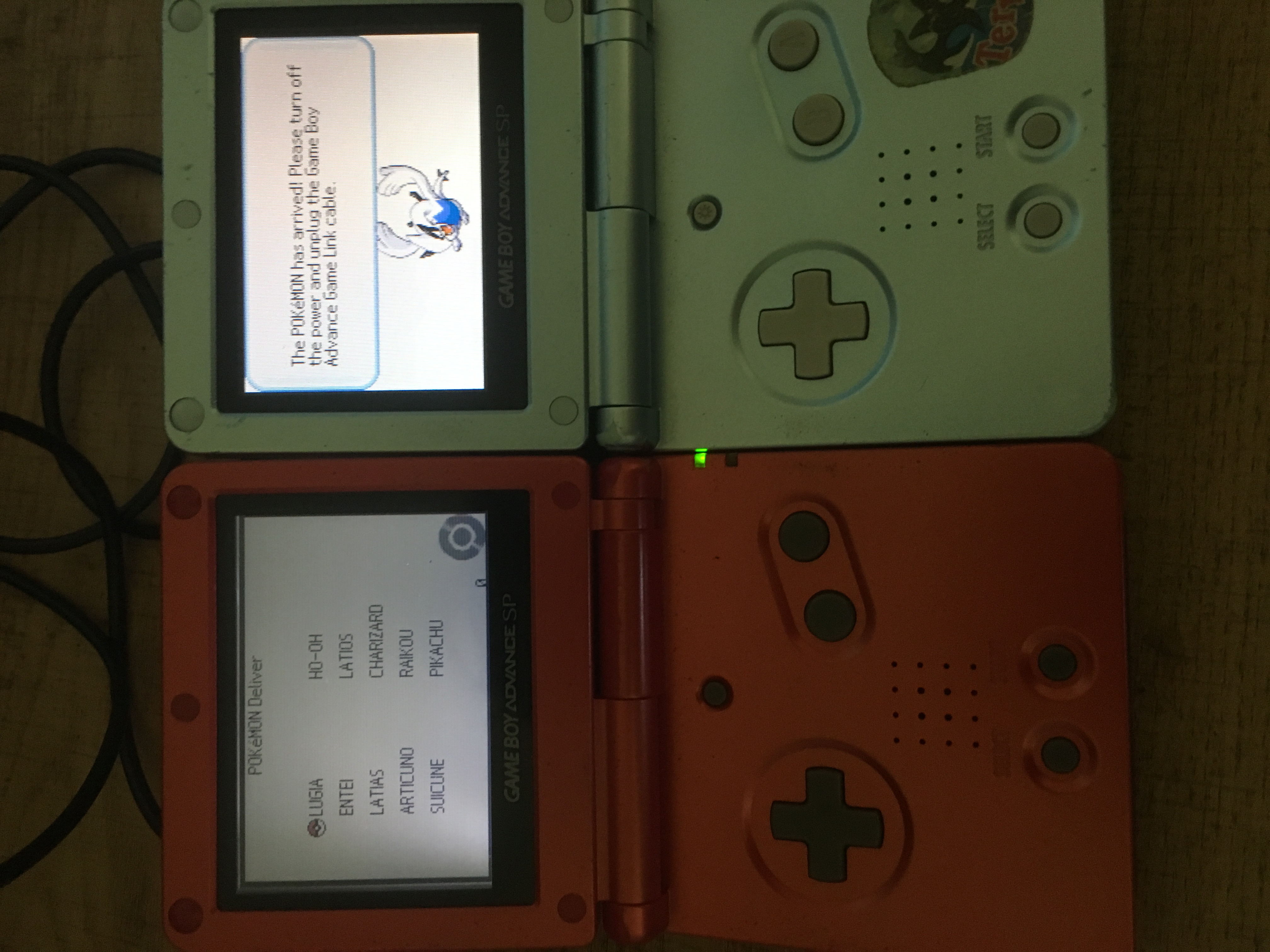

I used the cheapest flash card and the cheapest link cable on eBay and it worked! I think that if it works for trading, then it should work for transferring event Pokemon. All that is needed is that the "master" GameBoy (the one that says "Awaiting 2p linkup press A to confirm" when trading) is the one with the flashcard inserted. As you can see in the attached pictures, the ends of the link cables are sized differently. In my case with my link cable, the smaller one needs to be attached to the GameBoy with the flash card or else it will not work. Hopefully this is the explanation why it sometimes transferring Pokemon doesn't work with some people (if not, I guess I just got lucky). Hope this helps people that have problems with their third-party link cables.View attachment 16644 View attachment 16645
