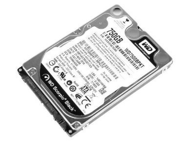

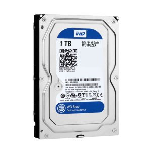

  9. Rick
    Rick Moderator
    2,852
    1,288
    Arcade games will work without the emulator.
    You will need a wd drive that would fit a laptop.
    A wd drive that looks similar to this, but not exact.
    This drive will fit in a desktop computer and won't work on the xbox 360 without any extra modding.
