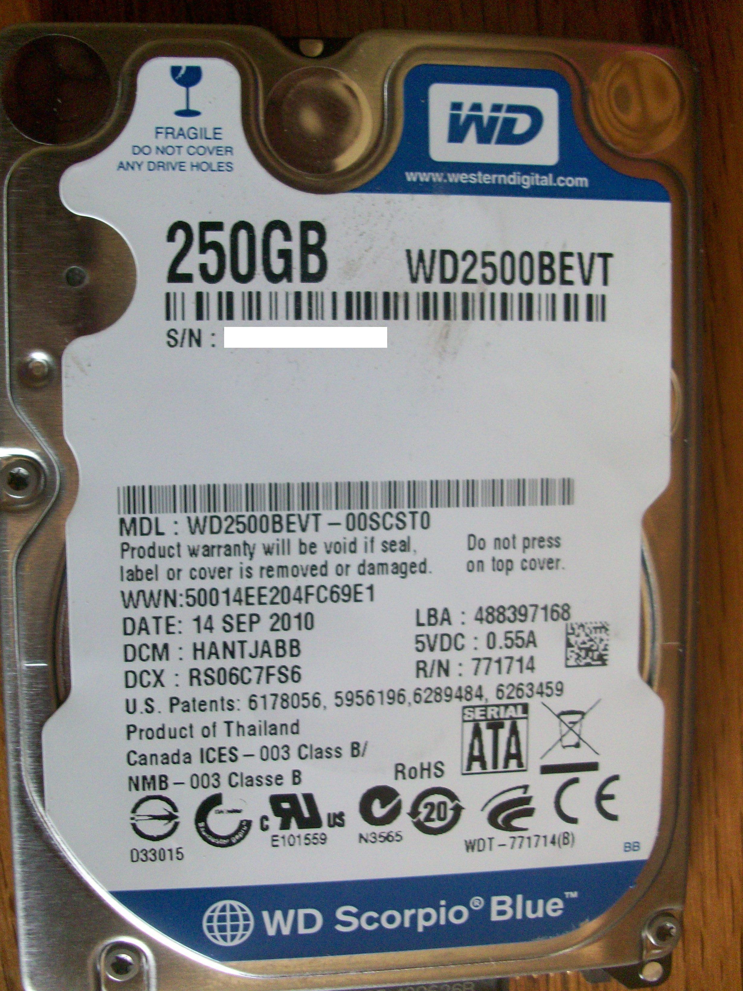

    First of all GREAT GUIDE! So, after looking at this thread for a while and seeing what errors people have been encountering and weighing the pros and cons, I decided to give this a try. I bought a scropio blue drive 250 GB made in OCT 2010.
    I went through the hddhackr flash process but with it gets to the end instead of say congratulations....etc, I get a error message "Bad/Wrong Modelnumber offset!"
    How can I fix this, I feel like I am really close to successfully finishing this so any help would be appreciated

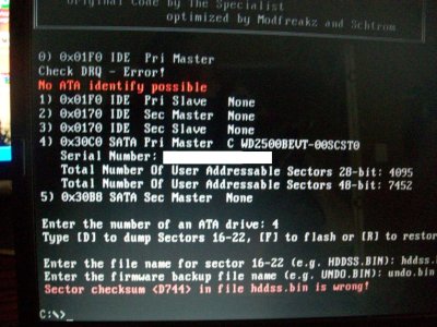

    Help guys. This is as far as I can get
    250 gb 011.jpg 250 gb 012.jpg Screen shot was taken off my older hp laptop which gave me the upper and lower error lines. When trying to flash from my desktop I keep getting the lower error only. Desktop is running a asus p5kpl-cm motherboard with intel g31 chipset . Have searched thoroughly through both bios on laptop and desktop and found no turn offs like you suggested in your tutorial. And have tried to turn off anything I thought might be relative. At a loss and need some advice.

    I have the same problem as You. Disk production date: 15 OCT 2010...
    In HDDHackr

    I have the same issue. My drive was manufactured on Oct 19, 2010. WD2500BEVT. I get the same message every time. Bad/Wrong Modelnumber offset! Would I be better off, returning this drive and trying to get an older one? thoughts? Thanks guys!

    Over at the "official" place where hddhackr is hosted others have also written about this and the author requested the undo.bins from these new HDDs for research.
    That post was made today, so we will probably see an updated hddhackr soon.

    The author has fixed the Bad/Wrong Modelnumber issue for the new drives in HddHackr_v1.25_Build_20101114. Damn good work by him. Sorted in less than a day!! :)
    His notes:
    * Extended Modelnumber String detection
    (new hard drives have two Modelnumber strings)
