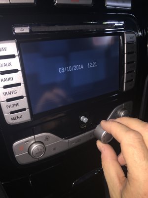

2. Carefully pull the volume knob to remove it

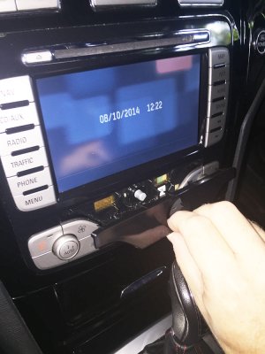

3. Now carefully remove the plastic cover which surrounds the volume knob - to do this, pull from the bottom left-hand section of the hole gently with your finger

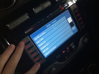

4. Now simultaneously press the NAV and MENU buttons, and a service menu will appear
5. Tap 'Eject DVD'

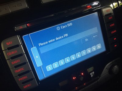

6. Enter your radio code
The disc will then pop out from below the display.

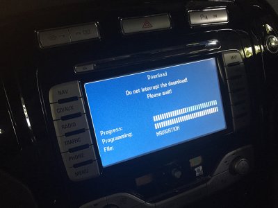

7. Insert the new disc, and you will be requested to continue with a software update. Tap 'Continue' and you will see the following screen:
This takes a few minutes. After completion, the unit will power off. Give it a moment or two, and then switch it on manually.
To replace the plastic cover, ensure that the metal retaining spring is located inward at the bottom, place the cover in position at the top, and press inward at the bottom for it to pop back in to position. Then just gently relocate the power / volume knob.
