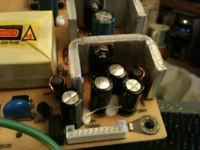

Update 2: So here are pics of the blown caps all 4 monitors had the same 2 blown caps in the power supply image(2).jpeg

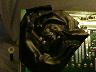

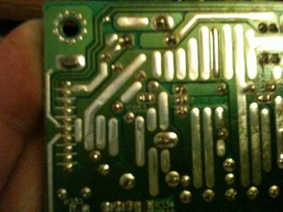

Here is a pic of the back of the board right at C553 (its right in between the points I have to unsolder and resolder new caps in) image(3).jpeg Heres what i've done to protect the areas that i dont want to get solder on or melt whats there image(4).jpeg The only thing I have is Black tape so I covered everything but the area's that I'm working on, good idea or bad idea? (I've done that on the other 3 and they are all working great)
