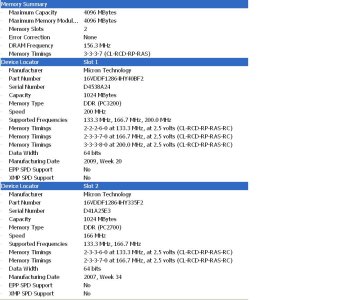

Hi guys, I really need some feedback in regards to using two different types of RAM.
I have attached a picture to this post. I have one with 200MHz and the other at 166MHz, PC 3200 and 2700,
Would this affect the performance of my laptop?
Thanks! any feedback helps.
Furthermore, how come from this system info test, it says that the maximum capacity is 4096MBytes?
