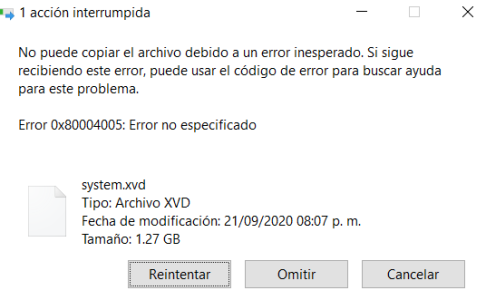

hola, gracias por la actualización, solo q ya la baje 5 veces y el archivo system.vxd tiene el crc erroneo. si pudiera checarlo y poner una copia correcta en torrent, gracias...

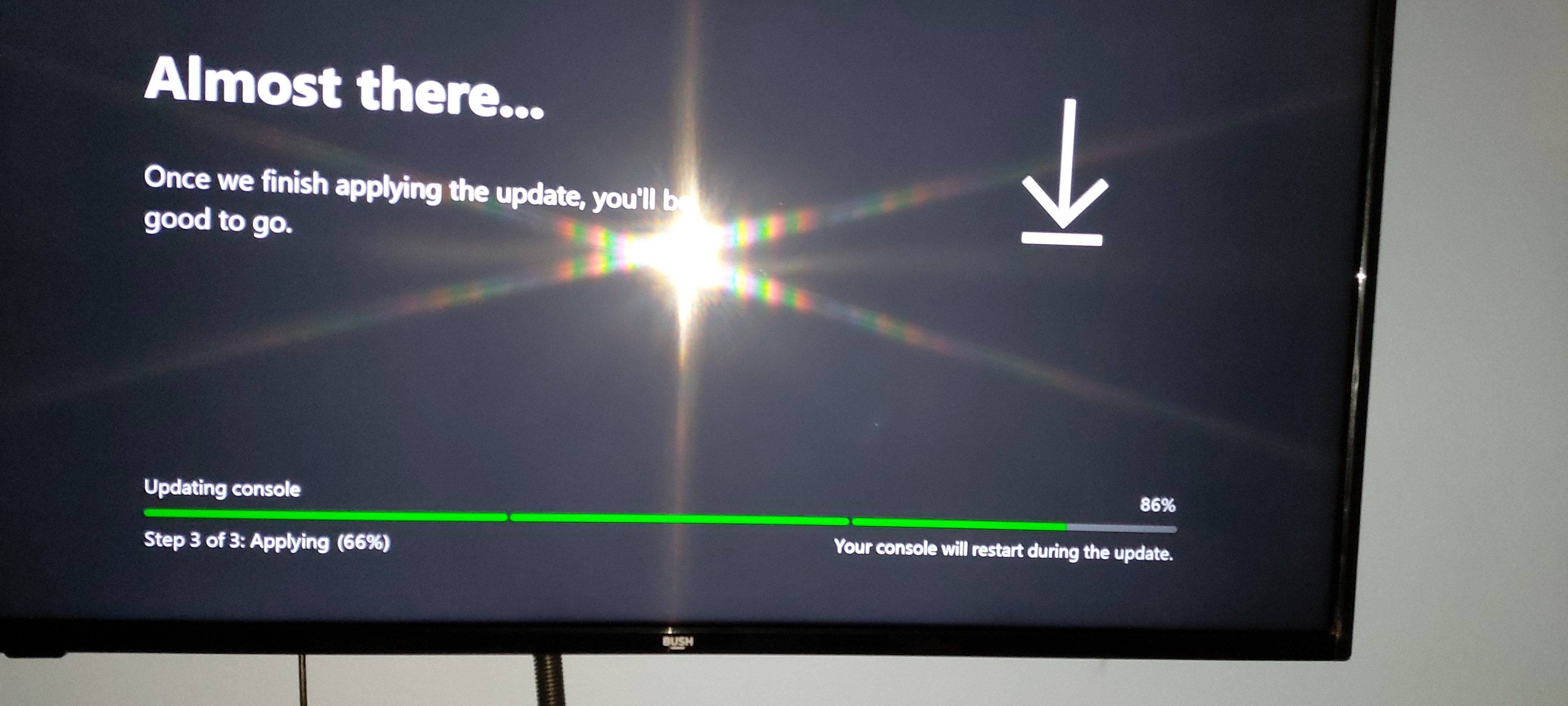

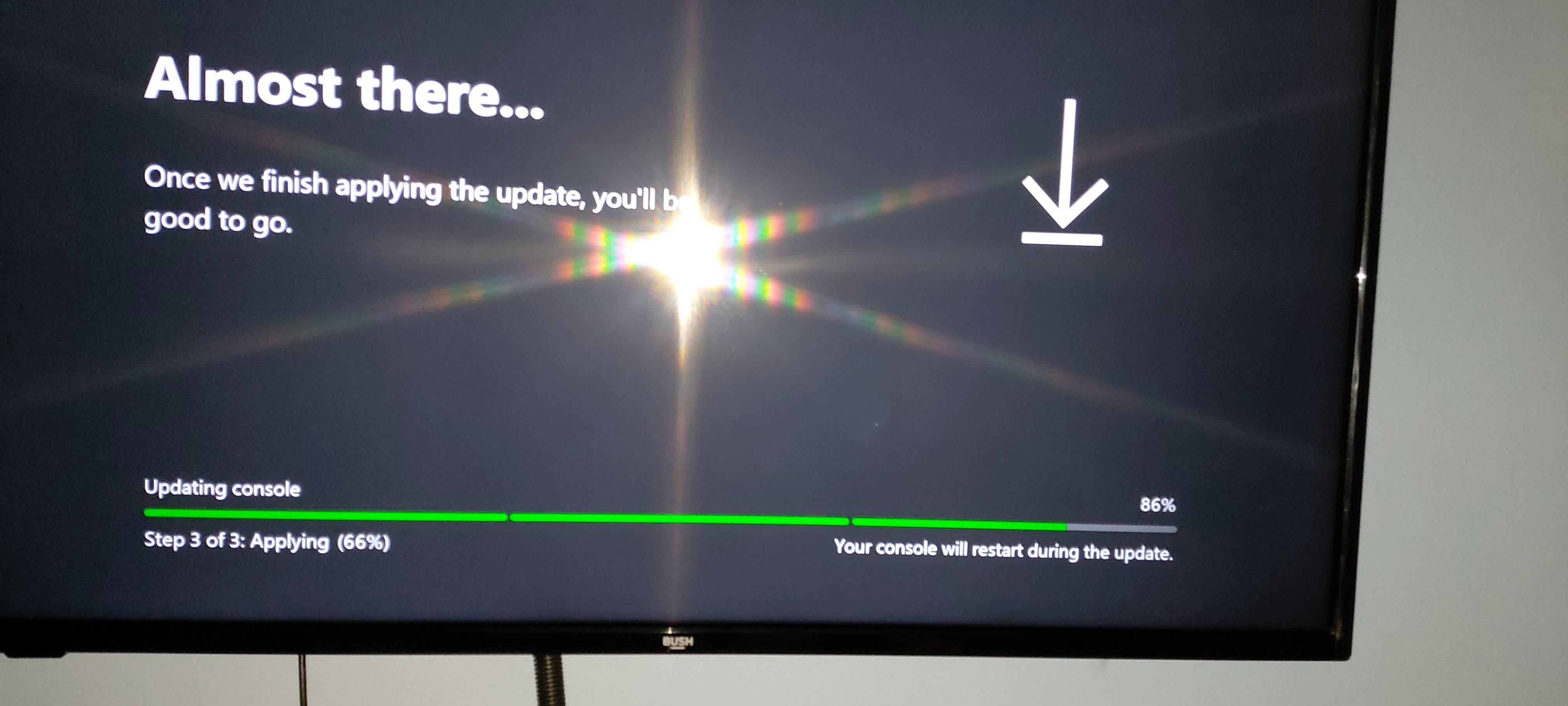

will the latest OSU revert the console back to normal? currently console not working as stuck in update loop have tried both reset methods but starts at installing 72% overall and hangs at 86% overall I have the LAN cable connected too

@InsaneNutter did not work tried the offline update , it goes through process ( download / verify / apply ) when it applies it just hangs on 66% with the overall on 86%
If I try both reset methods it starts on the apply stage at 72% and again hangs on 86%. have tested hdd all is good and have also tried with brand new drive all the same.

View attachment 17521 @InsaneNutter did not work tried the offline update , it goes through process ( download / verify / apply ) when it applies it just hangs on 66% with the overall on 86%
upd8 : tried latest update via xbox site and still no luck
Not too sure why it hangs unless something is some how corrupted on the hard drive so it can't apply the update, on the new hard drive you tried in the console did you prepare it for Xbox One use? https://github.com/Juvenal1/xboxonehdd
